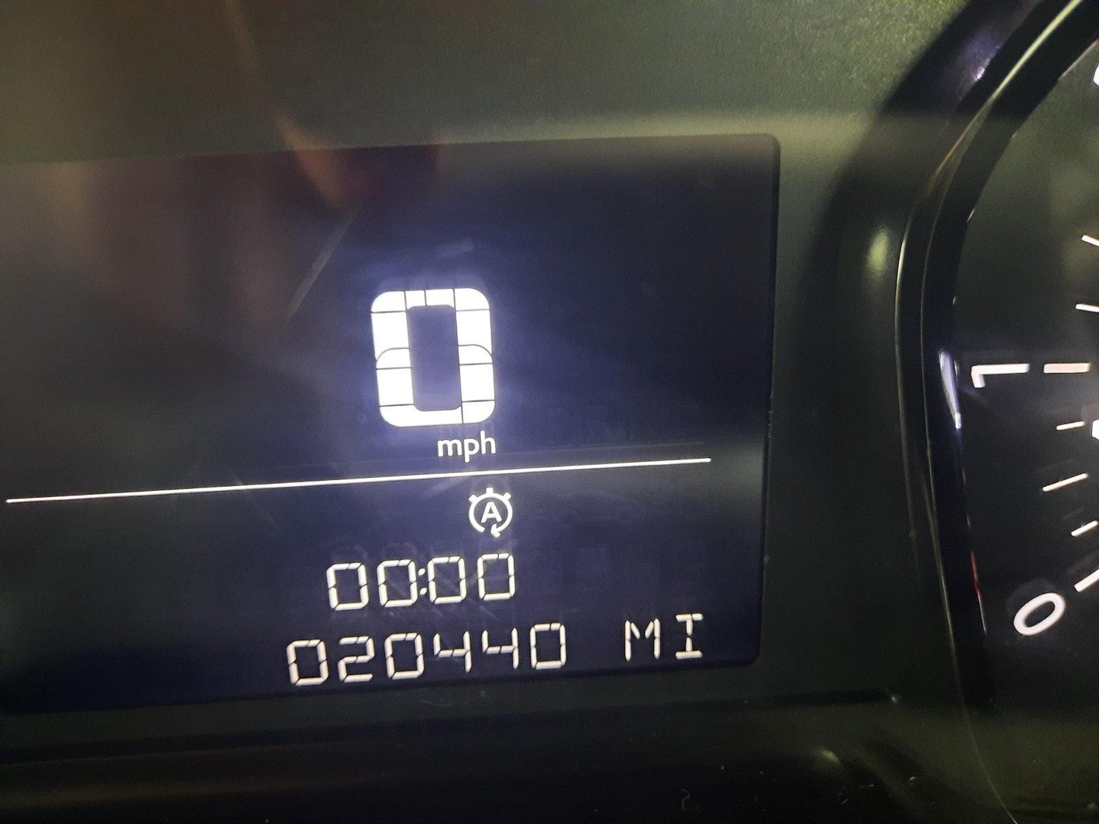

Hi All,
Does anyone know what a white circular A symbol with 3 lines on poking out the top means on the dash just below the digital mph number?
It looks similar to a stop start symbol but isn't green instead it's white.
It's constantly present and symbol isn't in the manual.
Ps stop start hasn't worked for over a year not sure if its anything to do with it?
Look forward to your responses.

MIne doesn't work more than a day or so either.
I think that the 4 '0's under the Stop Start symbol (the A with the circle) is either a counter of the times Stop Start was last active or time since last Stop Start action - which as yours isn't working wither just leaves it blank.

It's just the identifier for the timer underneath which shows how much 'planet saving' you have done (time engine stopped....). Ours, 2017 C4GP has been resolutely stuck on zero for about 2 years
