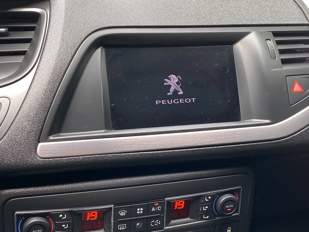

Hi everyone,
I picked up my new C5 X7 Tourer on Friday and it's blown me away with how good it is. My wife and I drove it 400km down to her parent's place and it was so smooth and comfortable.
There is, however a little curiosity with the stereo. It has the Becker NG4 stereo - aka Navidrive 3D, and this is what greets me when I start the car: It also came up as "Peugeot" in the bluetooth list when I connected my phone to it.
Can I change that easily with a secret menu or a firmware update?

Hi - I've moved your post to the Telematics Forum.
I think I know what has happened here. There are 2 possibilities I can think of:
1) Your vehicle never had this system originally and a previous owner has replaced the original Head Unit with the NG4 system which was from a Peugeot.
2) You did have the NG4 originally, but something happened to it and it was replaced with a unit from a Peugeot.
In either of the scenarios above, whoever replaced it did not know how to configure the unit properly for your vehicle using the diagnostic equipment (Diagbox).
If you pop your VIN up for me (automasked on post submission), I will check your vehicle's original factory equipment to see if you did have the unit originally.
In order to change the logo back to Citroen, it needs reconfiguring using Diagbox to change a parameter in the ECU. The unit you have has still retained some of the programming from the previous vehicle. This being the case, there may be other settings that are incorrect for your vehicle. A firmware update won't be able to correct this (please advise which firmware you are on by obtaining this from the setup menu). It must be configured using Diagbox (often referred to as a Lexia kit).

Thanks for moving to the right place and for the info.
In the thread I started before I bought the car viewtopic.php?p=690572#p690572 I posted the vin and it did indeed originally have the NG4, so I guess it broke and was replaced.
The firmware version is ng4_D_N32b_N32.05

Ahh, this is interesting. I may have the original unit, as they been known to spontaneously change over from Citroën to Peugeot
https://www.planete-citroen.com/forum/s ... ot-citroen
It seems this is a bug of some kind.

This should not be the case as on this system it is set and won't get changed by any firmware update. Your firmware is old, and I can provide you with the latest and last version of you want - let me know. But to change this back to Citroen you will need Diagbox.

Thanks. A copy of the latest firmware would be great.
I’ll look into getting a Lexia and Diagbox. Or just take it to the dealer and see if they will do it.

Actually with this system (they are all slightly different) If I remember correctly, the logo is determined from the firmware itself - so it is likely somebody may have previously updated the firmware and / or maps from a Peugeot firmware file....
Anyway, I'm sending you a PM for the firmware.

I suspect you have replaced the head unit with a second hand one....?
If so the Head unit has retained some settings from the previous Peugeot vehicle it came from with different options to your own vehicle. That's the only way this can happen, unless somebody has been reconfiguring the Head Unit incorrectly.

As said, it's been reconfigured by somebody - it's the only way this can happen. Settings have been changed that are leading to the loss of functionality. I'd be pretty annoyed to be honest as they had no business doing anything like this - and I'd be demanding some reparation to get it fixed.
However I am willing to assist on the basis you are able to provide screenshots of the BSI settings (each page in order) and post these up as images.
I will check your current configuration against your VIN (Please post your VIN in full without spaces - it will be automatically masked from public view after submitting your post & will only be visible to staff), and can advise on any changes that need making.
To do this, run a Global Test, then on completion, near the top will be the BSI ECU listed. Select this to get to the configuration menu, then select manual configuration and you should see all the settings. Please don't change anything at this stage as what may appear to the uninitiated as obvious faults or incorrect settings, are in most cases default values that must not be changed, given that the telematics units like the NG4 require specific settings that may seem incorrect.
Once I have these, I can advise you on any irregularities based on your vehicle factory-fitted options.
To upload images, use the FULL EDITOR & PREVIEW button to reply, then select the ATTACHMENTS tab at the bottom, to browse the images from your PC. You can then place these in your post as needed.
I strongly suggest you name each screenshot as a, b, c, d etc., so that you know later which order to place them to save me faffing about with continuity of the settings.

Hello, I'll just hijack this thread...
Today my C5 also changed from Citroen logo to Peugeot one... I have it for 10 years and VIN IS VF7**************[VIN obfuscated, can be read by forum staff] ...
As per Citroen service in Slovenia when I bought it said that this is original that it came with and I still don't know why it would change logo now...
Can it be redone with firmware reflash? (I did it when it came out (lost of years ago this 42c I think it is))
I cannot find it anywhere on net does it need to be for Citroen or Peugeot or it doesen't matter?
Thank you for your help!

No, the firmware is not marque-specific. This can happen if the 'marque' settings have been changed in the BSI / Head Unit configuration or if a replacement unit from another marque has been refitted. It needs Diagbox to change it back again.

I've just realised I never updated this thread after 3 and a bit years.
I did however update the firmware with the one Marc sent me, and it did not fix the issue.
I also plugged my Lexia in, but didn't see anything obvious regarding the stereo. I will try again now I have read about the VIN issue here and elsewhere.
I think this happens spontaneously rather than anyone mucking around in there - probably an old firmware bug.

@Sebastian Tombs: As I said - the firmware will NOT fix the vehicle marque! The firmware is the same for all vehicles with this system. Your problem is down to configuration of the unit. I suspect it has been replaced with one from a Peugeot and whoever did it did not know how to configure it correctly with Diagbox. That is the issue - it has been configured for the Peugeot, not the Citroen marque, Easy to do when you know how.
