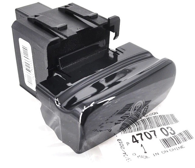

Hello everyone,
This is my first post on this forum and I'm really happy that I found this place where I could find many answers to my questions :)
I have recently bought a second hand Citroen C4 II from 2011, 1.6 THP and soon after I made several trips I noticed that the parking brake switch is no longer working (I cannot manually activate or deactivate parking brake). I would like to order a new one from Alliexpress, could someone, please, share here the OE part number ?
My VIN is: VF7**************[VIN obfuscated, can be read by forum staff]
Many thanks in advance!
wheeler
Posts: 7927
Joined: 21 Sep 2002, 19:07
x 1056
Re: Need help identifying part number for Citroen C4
Unread post by wheeler »
Part no is 470703

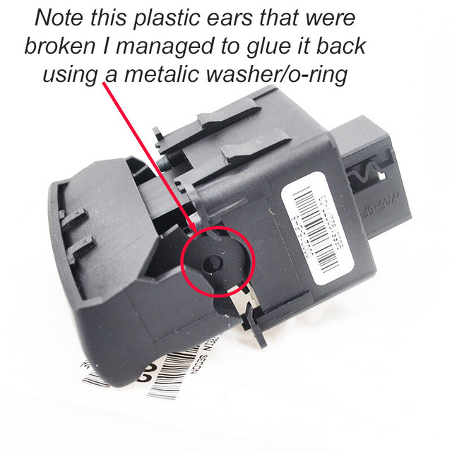

Quick update after I did some research on YouTube, this part has two little plastic holes that are fixing and letting the button to swing back and forward, I managed to glue the broken ears backed using a metal ring/washer and now the button works fine :)
Posts: 9273
Joined: 07 May 2009, 16:24
x 1931
Unread post by Paul-R »
An excellent result. Well done.
