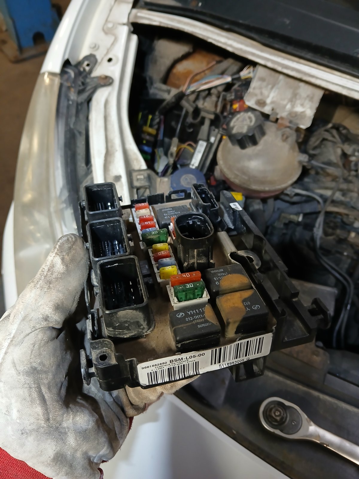

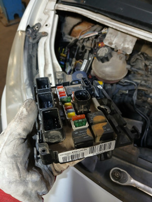

Re: Expert 2 litre hdi.No com with body comp U1118 and P1693
I managed to get it run again if i clear fault codes but it can shut down any time. I took out the BSM but there seems nothing to be wrong, it may be just bad connection with wireplugs but if i still encounter engine shutdown or not starting then i would replace BSM module.
Ok so I've removed the Bsm and no apparent faults visually. Put it back and now no cam crankshaft sync . It was starting to do this intermittently.
Have ordered a replacement to try that . Do I need to do a Bsi reset once I've put replacement in ?.
Tia
Should be plug and play, i swapped bsm with my other van that is same engine and both runs, will see if one of them still makes this problem, so far seems ok.
You should really have the battery disconnected anyway when replacing the BSM so this will naturally reset the BSI.
Ok so fitted the replacement bsm and no change.
The cam sync now seems a bit unreliable aswell.
