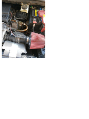

Is that a smaller bore of pipe than the original breather hose?

Yes, I made an adapter and the filter house is normal water filter.
I thru away inner parts and adding an wire mesh on top, which captures oil into the can.
Input tube to turbo is from scrab yard from an old Opel.
Compare to this ( ).
