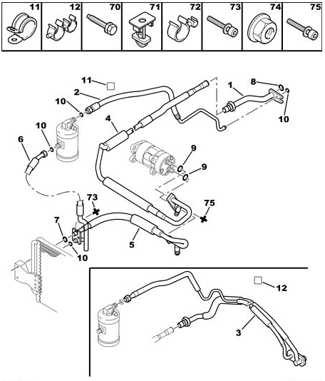

The A/C in my Xantia (2000 MK2 HDi 90) has not been working for a while. I discovered lately that the high pressure pipe that goes from the compressor to the condenser has a hole the size of a small pea. I was looking online for replacement parts and it seems there's no new parts available, only used and quite expensive ones for the condition they seem to be in (rust, no warranty, etc.).
The original part number is 9632230180 (from an old sticker in the pipe itself). My question is, is it possible to fit a different part number from other model years or DW10TD engines that's compatible with this A/C system and ports? Or something like "generic" pipes?

Do you have your VIN (automasked on submission), so we can put up a diagram to help you identify the correct part:

Sure, VIN is VF7**************[VIN obfuscated, can be read by forum staff].

Have a look below - some of these are still available. Let me know the number on the diagram:
