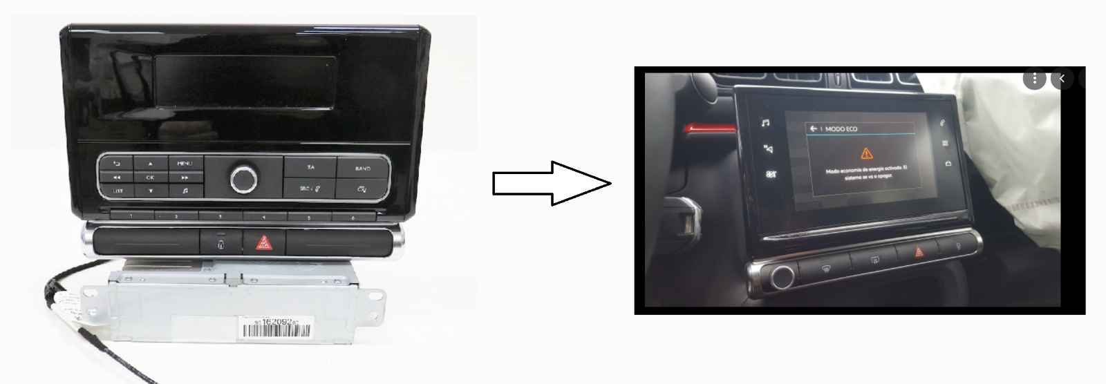

Just been thinking and searching if anyone has any idea if the stock headunit found in this model can be upgradable to the bigger screen that is in other variants?
Do you need other parts, modules, systems?
Thanks,
Adding photos for references

Yes you will. This is just the display. The telematics Units are behind the dash and are all different depending on type of multiplexed electronic architecture (Economy or Full), digital / analogue, options fitted (safety systems, cameras, parking assistance etc etc. and these will also have different wiring looms depending on the equipment.
