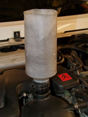

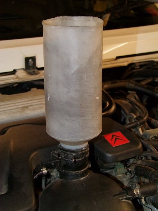

PSA use a filling cylinder and rod to assembly that goes on over the expansion tank for degassing.
You must ensure the A/C is OFF before doing this.
The long rod is used to open and close the tank safely during the process, but essentially for non-Euro 6 vehicles which yours will be,
Open the rod on the filling cylinder
Start the engine
keep the engine speed at 1500 - 2000 rpm, up to the second cooling cycle (cooling fan(s) cutting in and out).
Stop the engine
Leave the engine to cool.
Blank the filling cylinder using the blocking rod.
Remove the filling cylinder, plug and adapter assembly.
Check the coolant level when cold.
Top up the coolant to the "max" level (Cold).
The full procedure is similar as most PSA vehicles and full details are in the resources section here:
viewtopic.php?t=64036

Some 'stats open only at 85-88°C, which is pretty damn hot (domestic hot water is usually around 65°C). They are designed to keep the engine block (and cabin heater) at/near 90°C, which is the most efficient operating temp for a petrol/diesel engine. In very cold winter weather, the thermostat may only be a crack open, even when driving at speed.
A build-up of pressure in the system is a good sign (it prevents boiling), as is 'no bubbles' in the header tank.
The bleeding technique which Marc describes is simply designed to add a temporary higher header tank to the existing one, to help force air out of the bleed screws. A home-make one might look like this:
. Keep the bottle at least half full of coolant, while bringing the engine up to full working temperature (signalled by the cooling fans cutting in a couple of times).
While you do it, repeatedly squeeze the large top hose to 'burp' air out (you'll see any dispelled air bubble up into the temporary bottle), and open the bleed screws a few times each, until no more air comes out of them.
Leave the bottle in place while the engine cools, then remove it, and return the coolant level to the correct one.

Yet another use for a Fairy Liquid bottle....
