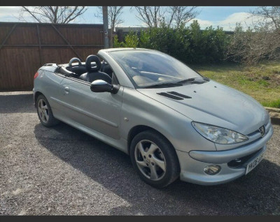

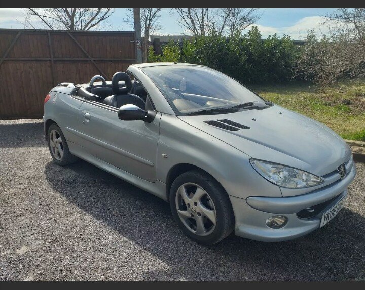

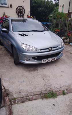

photo of 206cc
project cc
project cc

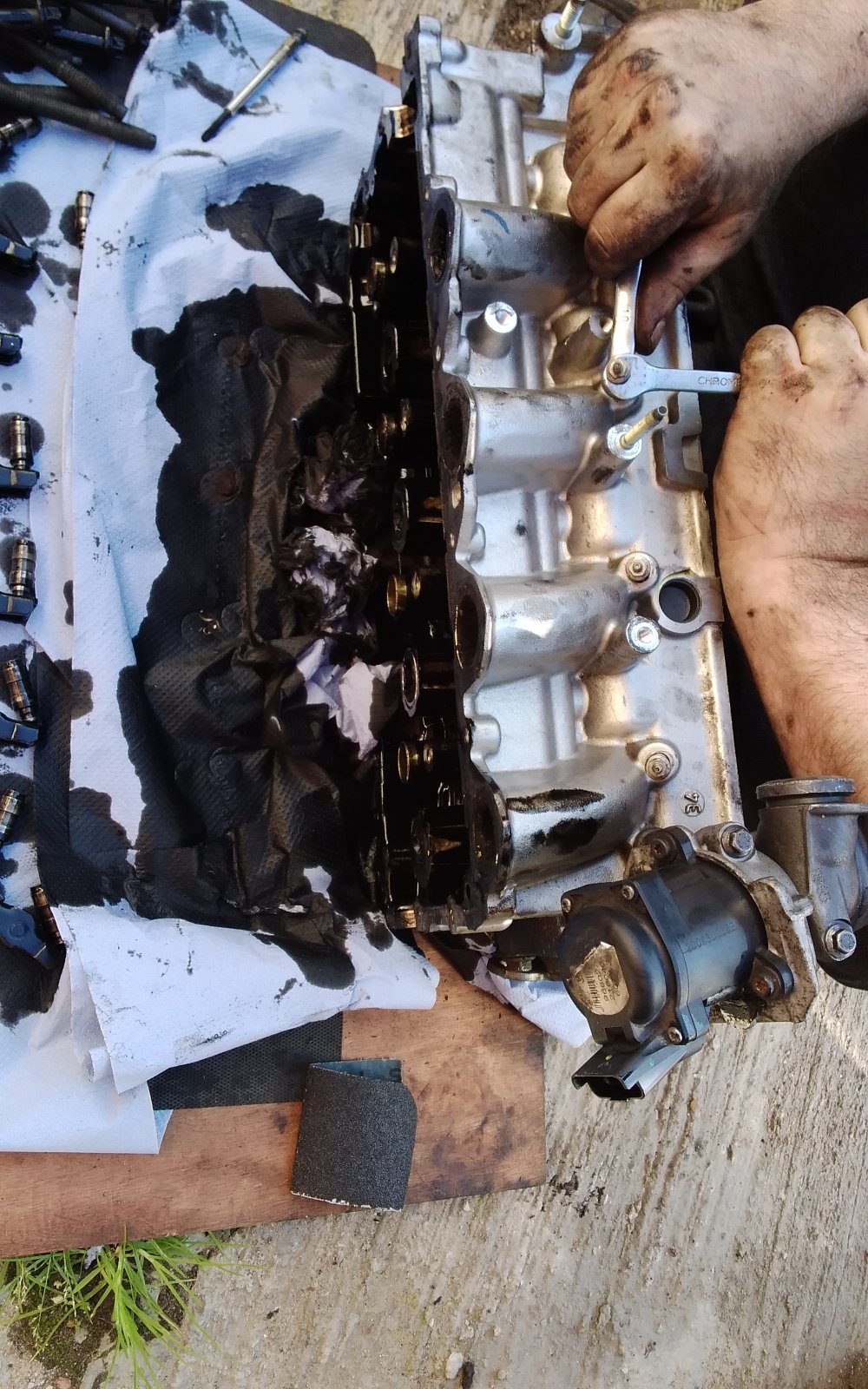

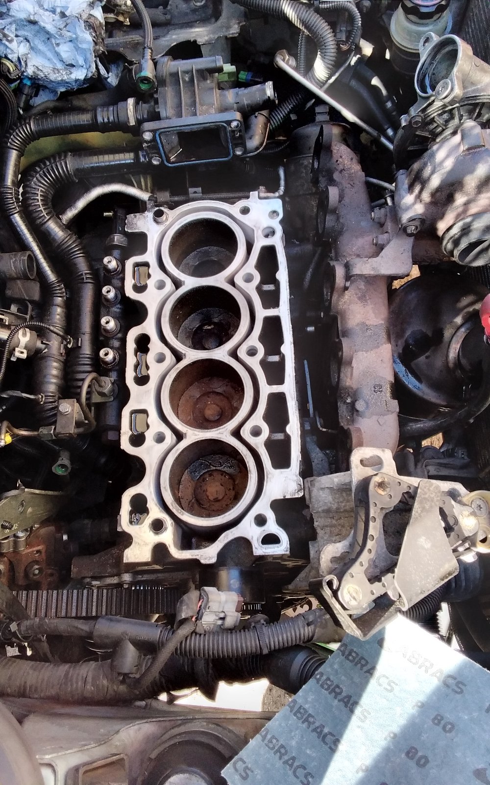

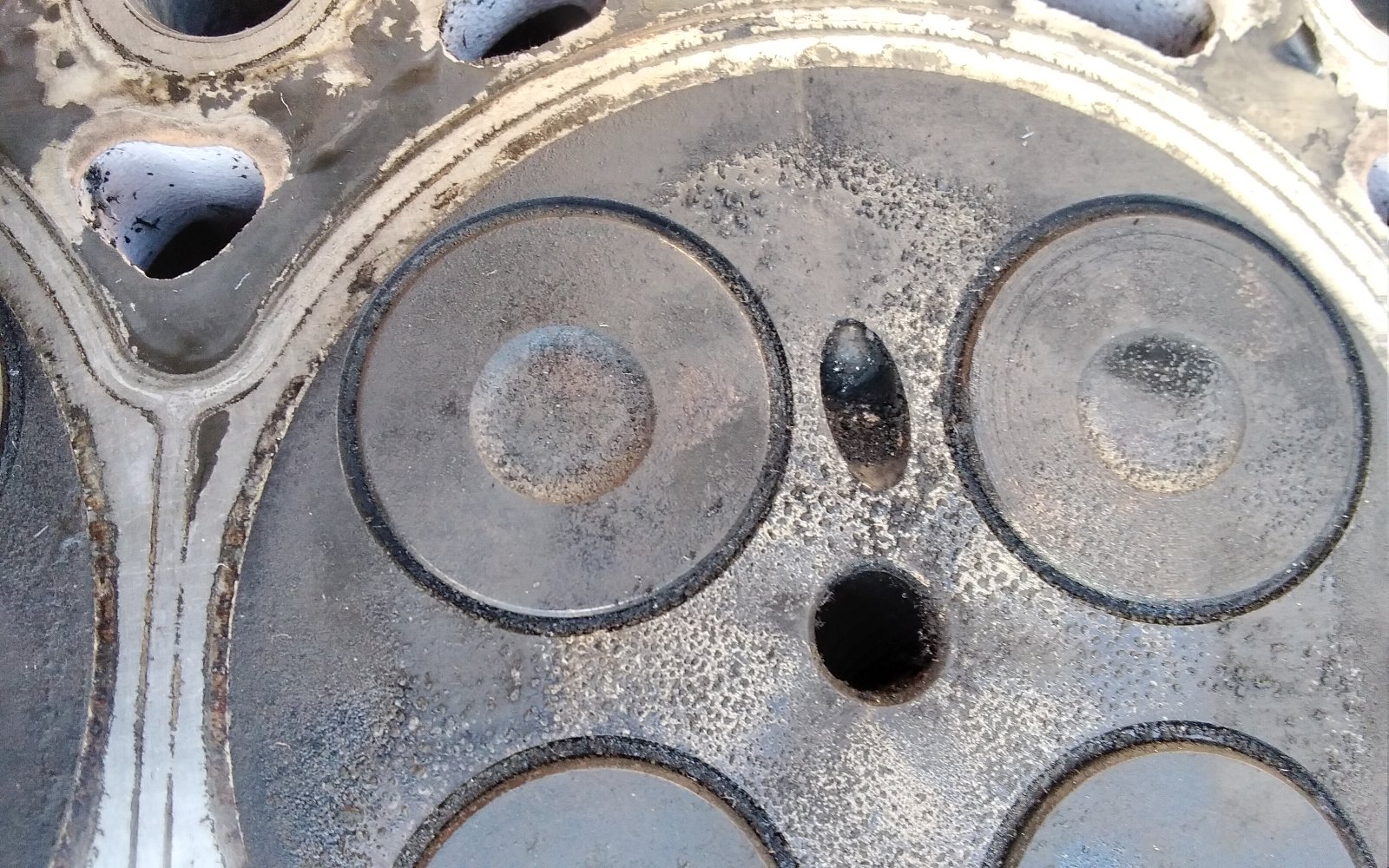

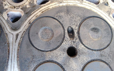

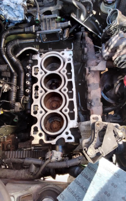

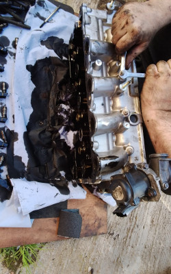

Hopefully work on car will be undertaken by jc recovery and mechanics soon I'll try to photo the undertaking of the process
Head gasket is just starting to fail
