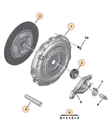

Has anyone got a part number(s) for the clutch and anything else I might need please?

The clutch kit (item 6) has a few options Pete:
OEM part: 2052K1 priced £385.66
Cheaper Version, part: 1636264380 priced at £163.50
or an exchange service clutch, part: 2051T9 priced at £200.00
