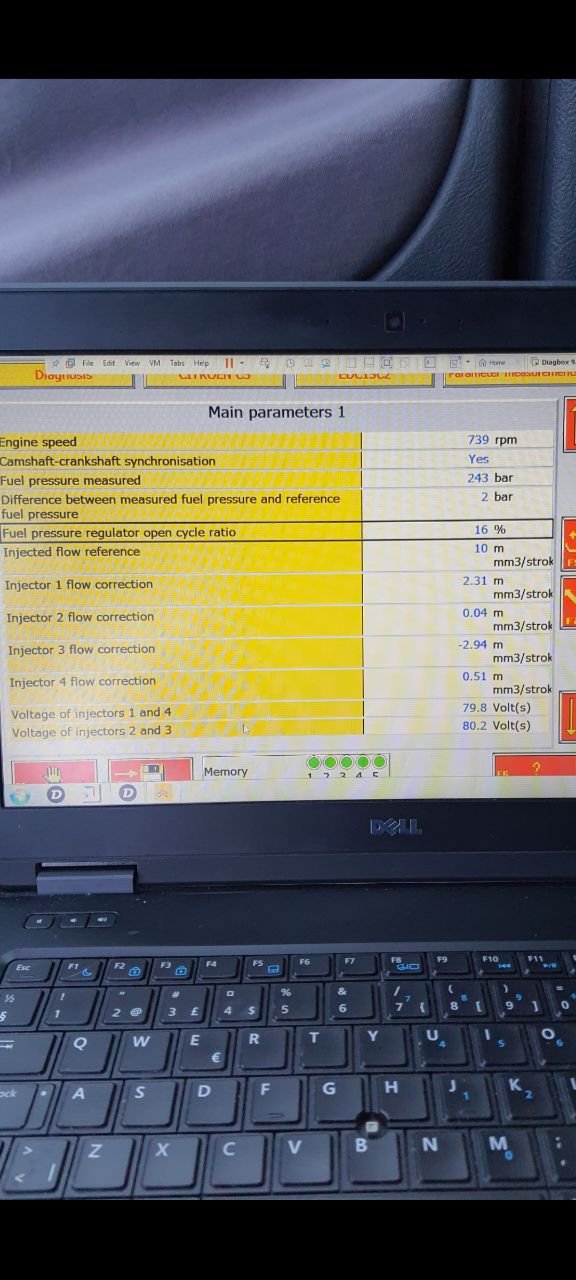

Interesting that you get values in % in lexia. When I was dealing with this I had values in mm3/stroke.
As far as I understood it after reading around on other forums up to 1 mm3 is okay 2 mm3 is slightly bad and over 3.5 mm3 is very bad but I am not 100% sure about that so someone else with actual info will likely correct me.
You do have to rev it a bit before the values actually show correct. As seen on my picture at idle they are all over the place and when giving it some throttle they all snap back under 1 on my car.
