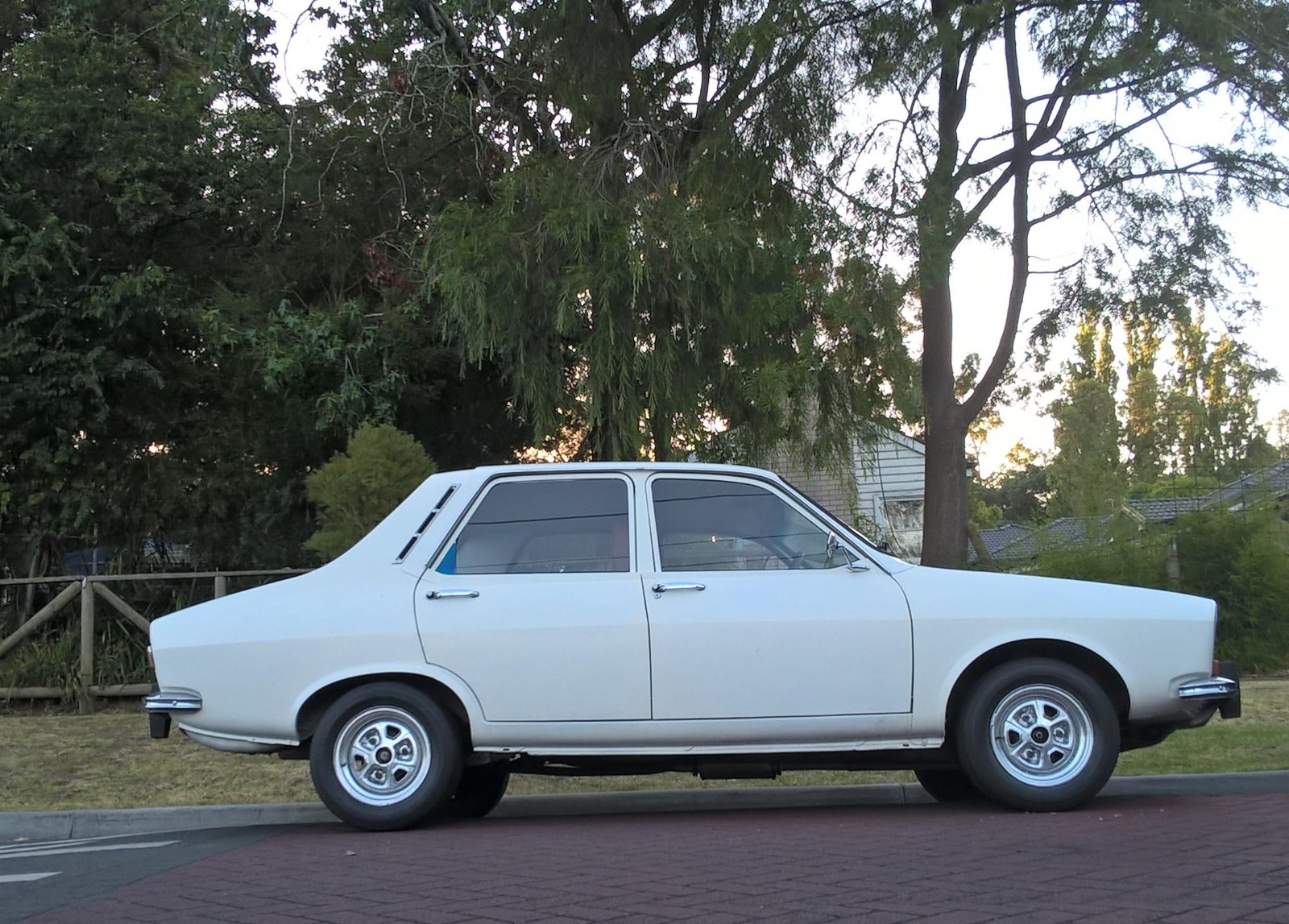

Here is the pile of sh1t I love so much when I picked it up (R1170 for ye fellow nerds, '71, 1298cc, 810, non vented discs,
Once washed and a few bits and bobs sorted it was alright (the mi16 I should have never sold but did so when the cam belt snapped)

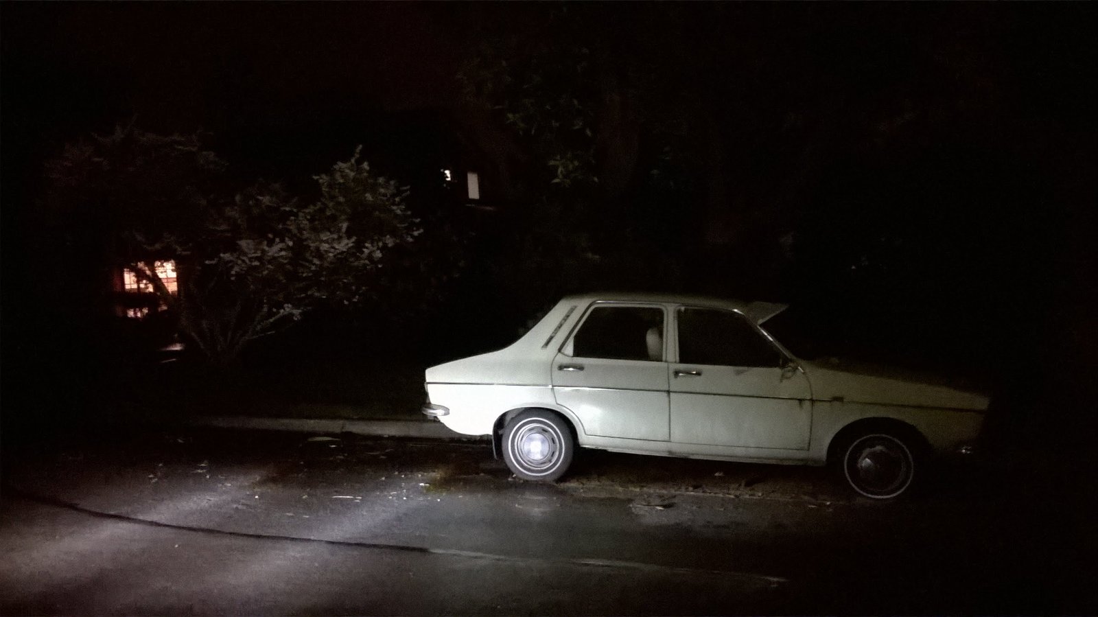

Then my neighbour hit it and I was sad
https://photos.app.goo.gl/9jTHqePnEX9frGGNA

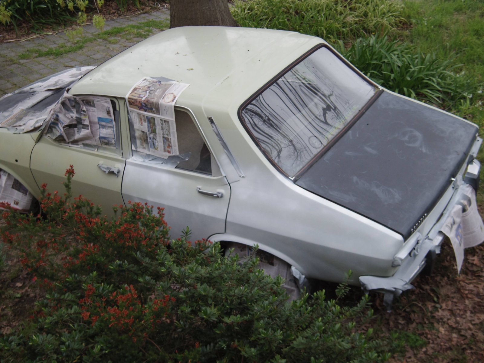

So I collected a new panel, and by that time the bonnet was a different colour, it was 4 different colours so I parked it under a tree in the front yard and painted it (because sunshine, thanks again for the beaches)
https://photos.app.goo.gl/ewxKoAWQNiXVoMAH7

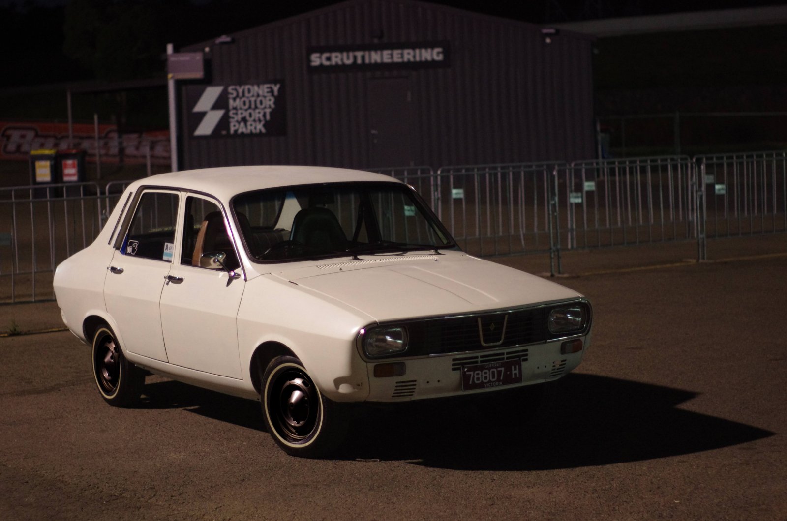

I found some old wheels a guy had made from cutting some R18 centres and welding them to wider hoops, it was starting to look cool :lol:
Fitting wider wheels was the single greatest thing I could have ever done to be honest. Wide wheels and fat tyres rule. Oh they are 205mm tyres FYI :P
I still had the cheese cutters, and I scooted around Sydney with them for a while
https://photos.app.goo.gl/qWz1oCFhahoM36w88
Black wheels look better

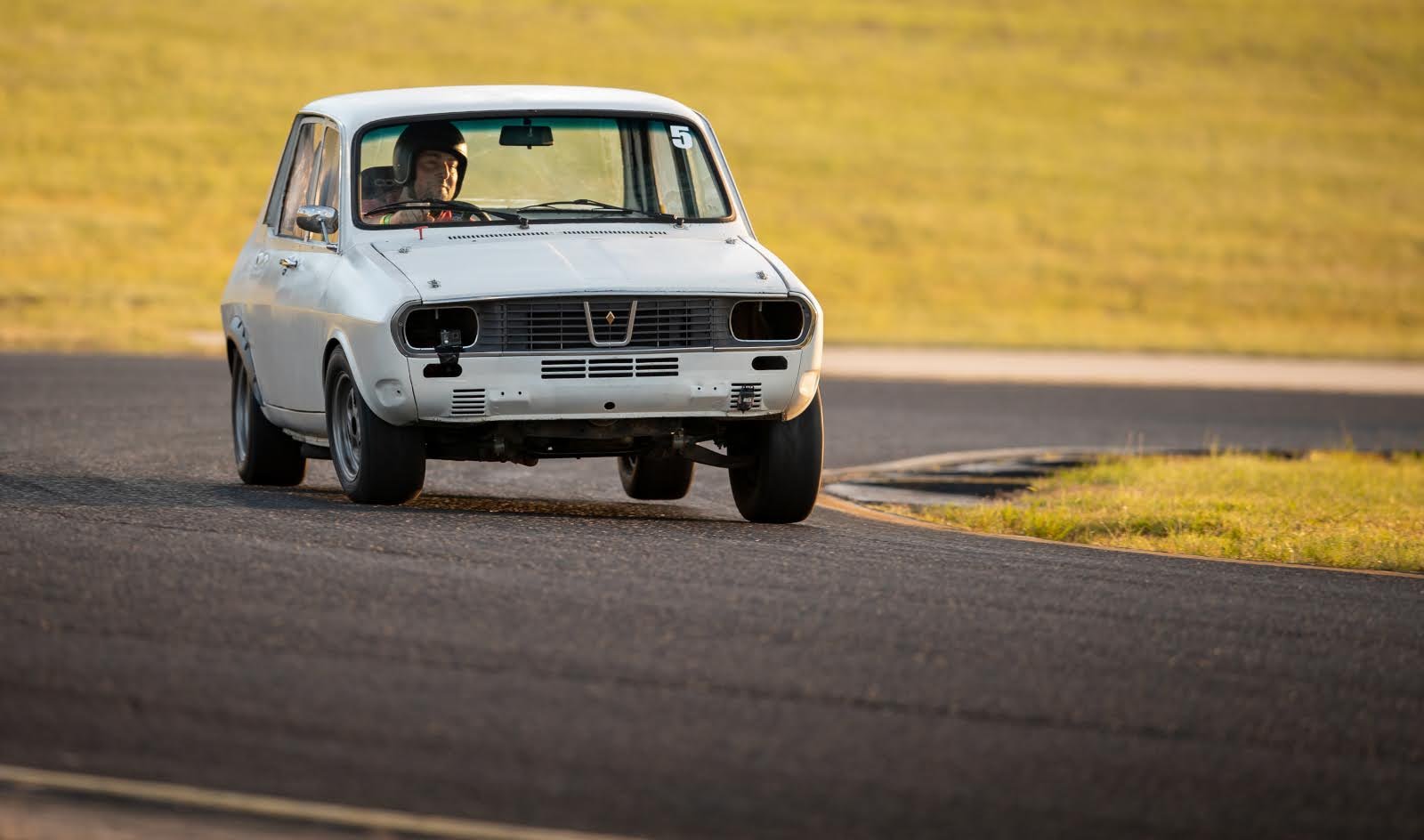

Here is a stock Reno 12 Vs a Nissan R33 GTR
Maybe a V8 Supercar
Having the doors blown off just wont do I thought to myself.
It wasn't long before I had found a set of adjustable Koni's and we chopped the standard springs.

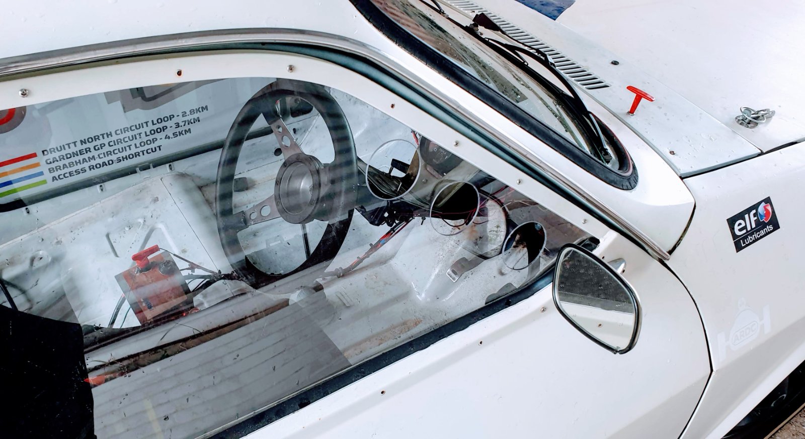

Then we just went around cutting and removing every we could. She is left with a glass front windscreen, and now has plastic everywhere else, along with every door stripped and most latches and what not removed. We got it down to 740kg. But I want to get it a little lighter before I add a cage, I reckon some fiberglass panels will be in order eventually.

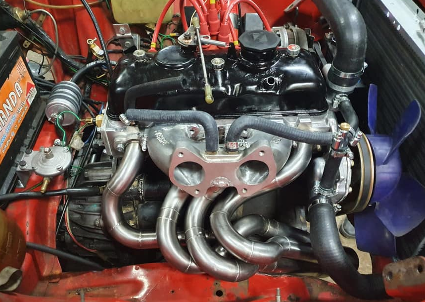

And in other news, I found some inspiration for my manifold creation.
Can't see it will end being that pretty but a kids gotta dream!
I'm going to cheat and get a DHLA / DCOE face plate at least, and I have a spare stock inlet manifold I can molest to make a cylinder head side template, and I'm not sure I want the primary exhaust tubes that long, but it kinda makes sense to position the 4-1 collector where they have. oh, and I'll start with a single, the twin DHLA's are really too big unless I spin the stoopid thing to 8k+
Another sensible chap made a template with PVC pipe first, I think I'll do the same and see how much sh1t this is going to be.

Definitely recognise the Renault bit. The rest is almost worthy of being called artwork. I calculated and sized the one off exhaust for a Lancia Twin Cam powered stock car (not the same where you come from) and set up and jetted the double twin choke Dellortos that went with it. I appreciate the amount of work that has gone into this. Got to drive the stock car on slicks in the rain at a mechanics race - made 3 out of 6 corners and didn't finish last.

You will find that bodywork/steering/suspension will limit your choice for primary and secondary pipe sizes and a single twin choke is adequate unless you are going for absurd power outputs in which case injection is a better route.

Well yes and no. The engine is hanging out the front of the suspension and steering of course, so it's not too bad.
I will have to be careful where i think the collector will go, and I think a 4-1 style manifold will be what I'll case, its placement will determine my suffering.

4 into 1 gives a better spread of (lower) power than 4 - 2 - 1 rather than peak power and is by it's nature more tolerant of mis matched primary lengths. Have you ever seen a Stacked 4 into 1 where all 4 pipes go into a large fishtail type box inline?
