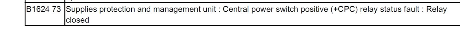

i have found a fault code related to the battery fuse box and attached a picture of it, do you think this would be the cause of the problem i read on another post that if the vehicle is not used much voltage drops can cause the central power switch relay to get stuck and shut down the unit, would this stop the mirrors unfolding and no ignition coming on

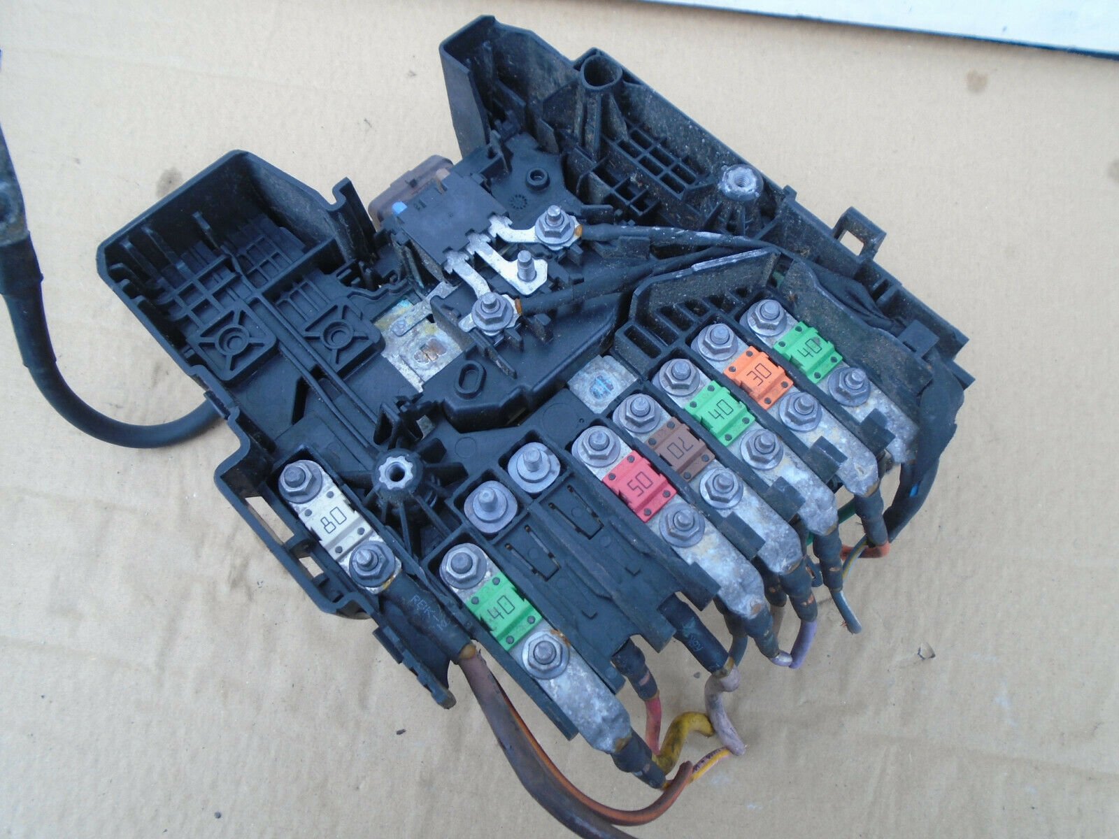

Seems to be some stuff on the net about this fault, but nothing conclusive. This appears to be the unit?
Must be a hefty relay in there?? 1.4V is never good... relay might do its thing if you give it a clonk when it is energised?

thanks for reply, thats the unit, will give it a clonk and see whats happens
