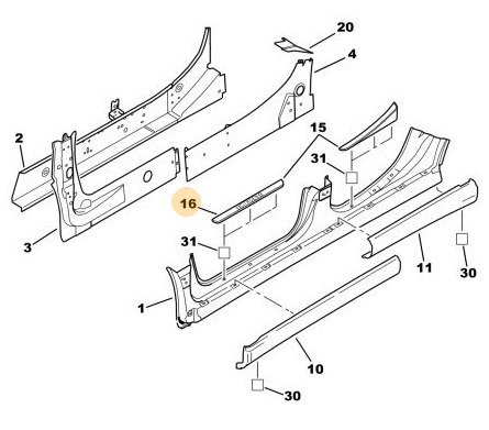

Does anyone know if the trims on the VTR facelift are the same on Hatchback and Estate? It is the front section that I am dealing with. I need one for my Estate but Hatchback are more common. These are on scrap cars at distance, so parts will be posted and no chance to compare.

The underbody mouldings (10) & (11) are the same between Saloon & Estates.
The Side Sill Mouldings (Front) (16) are either with, or without Chrome Trim - that's the only difference apart from left and right sides of course.
For Item (16) part numbers:
Left 7009J8 without Chrome trim.
Left 7009J9 with Chrome Trim.
Right 7010S0 without Chrome trim.
Right 7010S1 with Chrome Trim.
