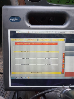

Hi,

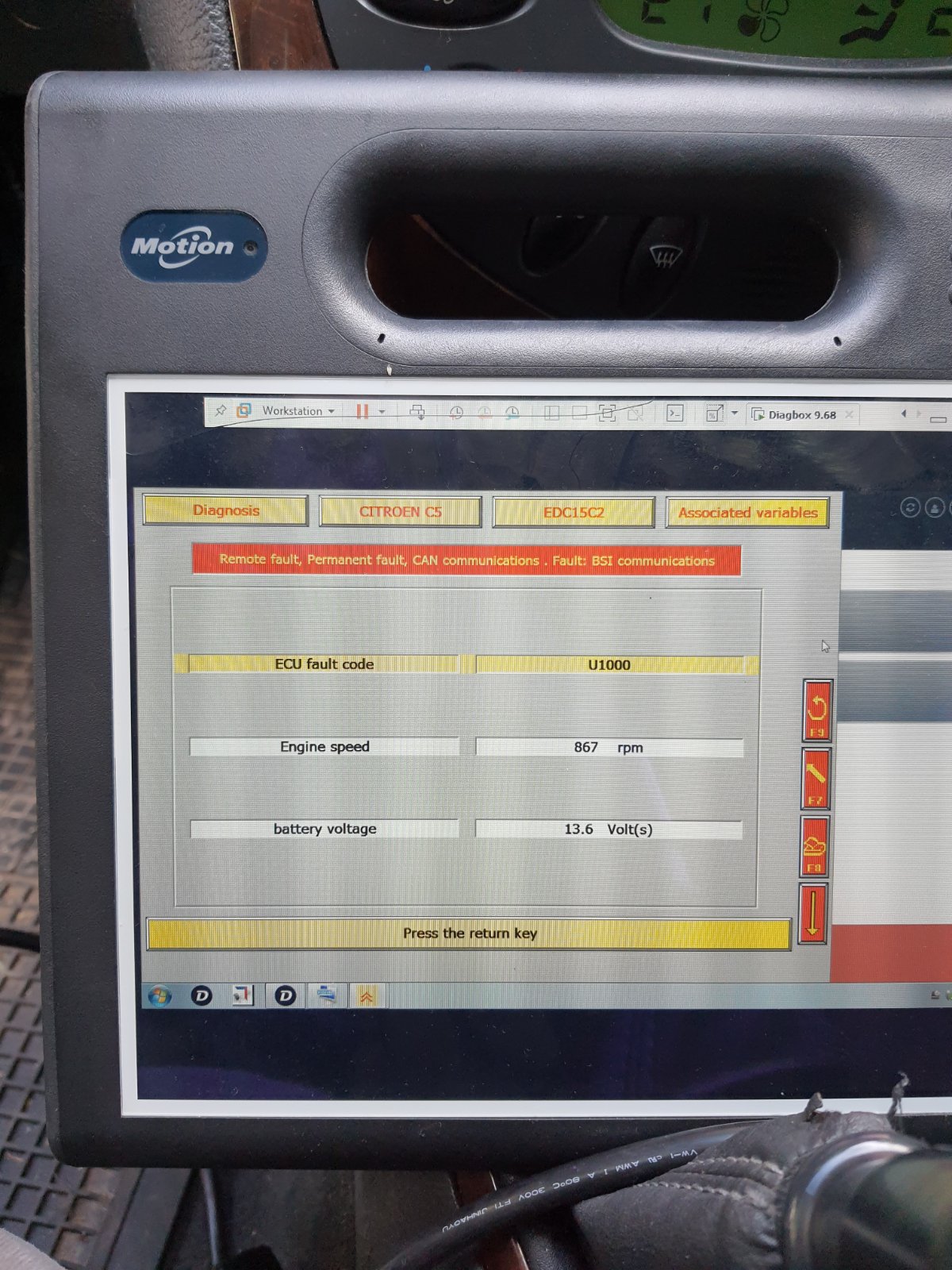

recently my c5 got a fault code u1000 (lexia says remote fault, permanent fault, can communications fault bsi communications) on the engine ecu (edc15c2).
As far as I know from other posts this means that the engine should not run at all as the engine ecu can't talk to other ecus (in this case I guess the bsi specifically).
However it works perfectly fine except from a few faults I don't think are related like radiator fan never running (not even with aircon on or a severe coolant overheat) except during a lexia fan test or the misbehaving automatic wiper sensor that randomly increases or lowers the wiping speed as these have been present ever since I bought the car.
There are also sometimes fault codes in the instrument cluster ecu for lack of engine rpm data and similar inputs but I have never noticed the gauges dropping or reading wrong.
The problem is that this fault code triggers the check engine light and antipollution fault message which will cause me to automatically fail the yearly test (MOT) when it's time for that and so I need to find the actual problem and repair it.
Visually the engine ecu plugs and wires look fine but I haven't yet taken it out to check more closely and reconnect them. Any other ideas what to test or check for damage?

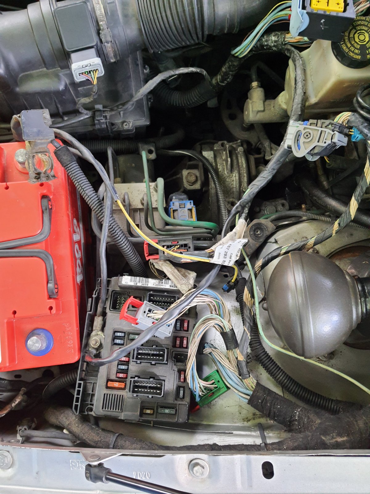

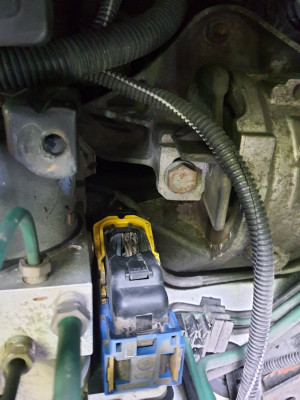

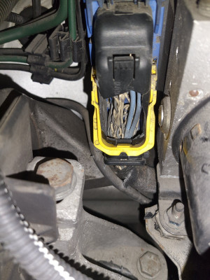

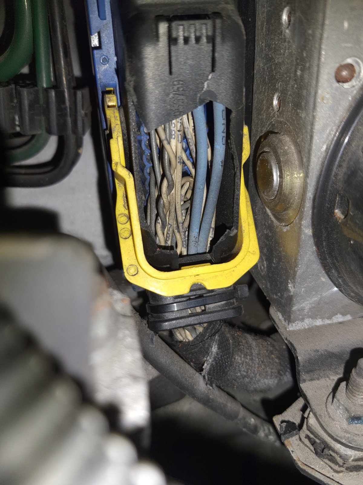

I removed the plastic engine ecu/fusebox tray to get to the abs pump under it. The plug for abs is somehow smashed in the back (picture attached) so I assume the first owner must have been knocking something around in there as I cant see anything in there smashing it by itself. However none of the wires seem to be damaged and the connector itself seems fine.
I have also checked all other engine ecu and bhi connectors and they all seem fine as do the pins. Car still runs fine besides the check engine light/code.
I have noticed that the can error code only comes up after being wiped when the engine is actually started while another (not connected to this issue, it was always there) code for glow plugs comes up instantly when the key is turned to the on position - even before starting the engine. Is this relevant in any way to diagnosing this or just the way it works?
What is the next step in going about locating and fixing the fault? Remove the BSI (inside the interior fusebox?) and check the connectors on that?
x 6956
Re: c5 mk1 2.2 hdi code u1000
Looks a bit of a mess. Although I don't have anything on U1000 for this engine ECU, I can tell you that on the later 2.2 engine with Bosch EDC16CP39 engine ECU, that error means CAN communication: Engine ECU dead.
Looking at the state of that plug, I wouldn't be surprised if there is an intermittent issue. It's going to be something you'll have to investigate a little further - I don't think there's much more we can do at this end to be honest. But I would certainly keep checking the connections to and from the engine ECU.

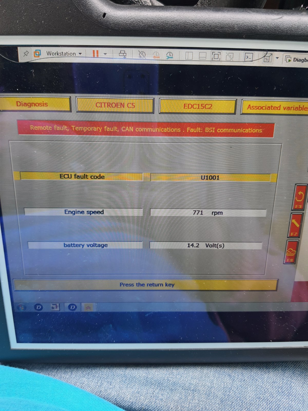

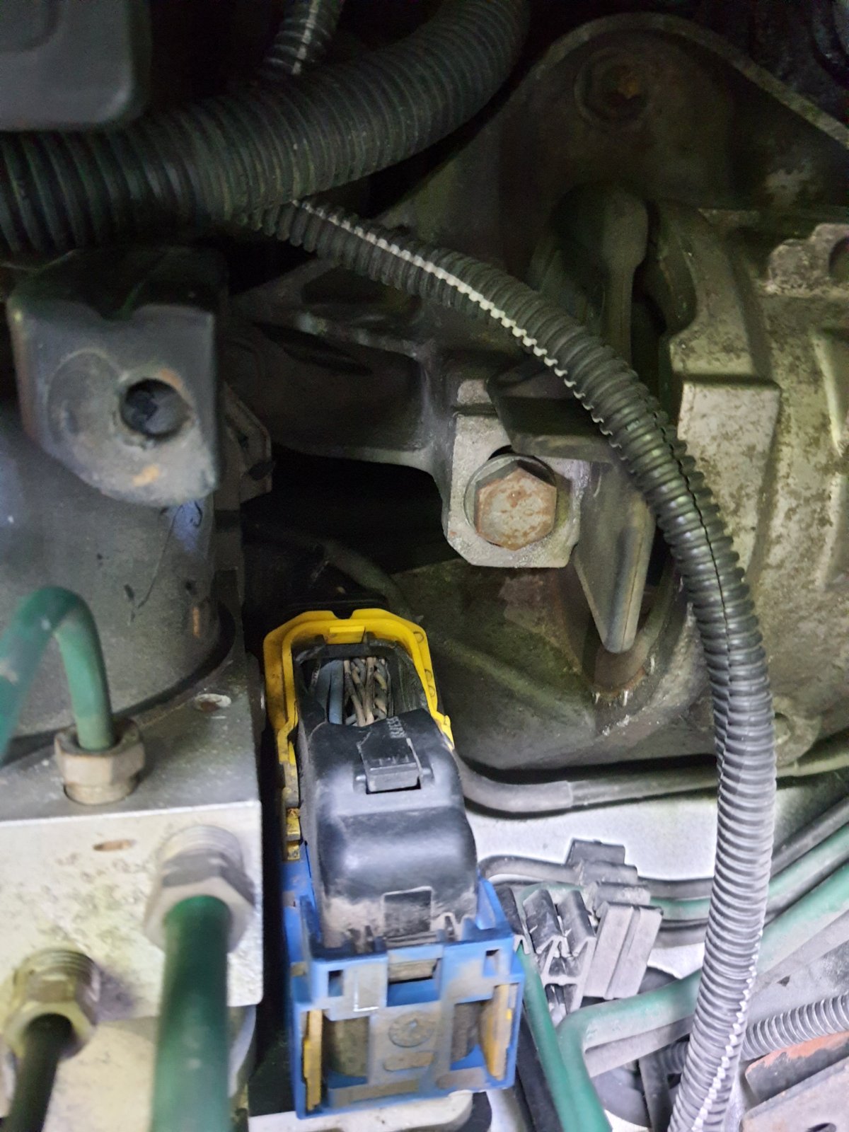

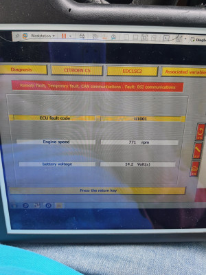

U1000 is still there however there is now also U1001 but only intermittent not permanent. I have also got an abs fault yesterday after hitting a pothole very hard but that went away after a restart. So that suggests a loose connection somewhere (likely in the smashed abs connector?)
So, what does the new U1001 code mean? Or is it just another generic can fault that gets us nothing new...

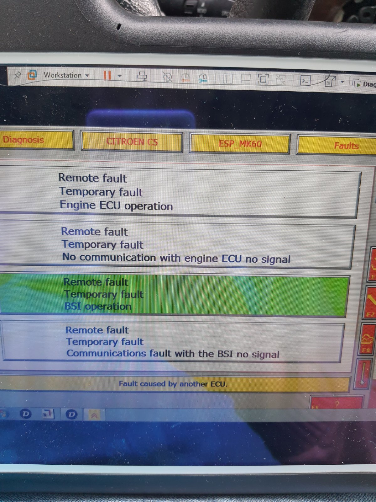

Also most ecus in lexia now have the thin red line around the main window which was only on the engine ecu window before (the red line I assume is communication problems? Couldn't find any info about it).
I guess the best thing to do is let the car go even more crazy over some time at which point some useful codes might pop up to point in the correct area with the issue?
