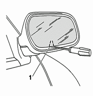

Re: Door mirror viewing angle/adjustment question.
Here you go Matt: It's also possible that a non OEM mirror may have been previously fitted.
Removing
Unclip the clip (1).

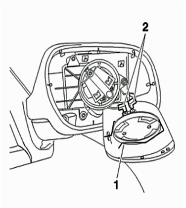

Disconnect the connectors (2) (according to equipment).
Remove the glass from the mirror.

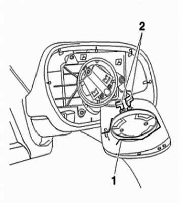

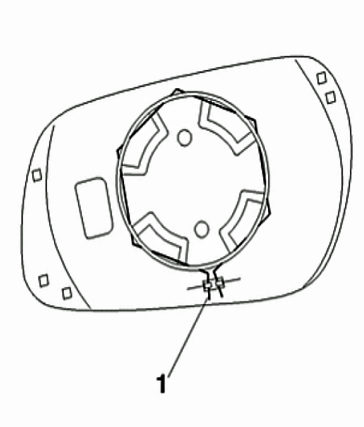

Refitting
Ensure that the spring clip (1) is correctly located in its mounting.
Clip the unit onto its support.
