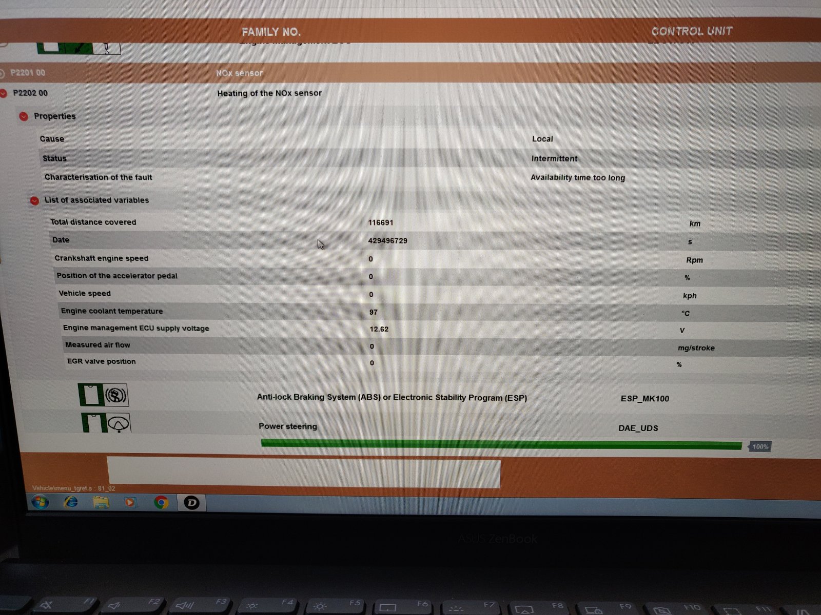

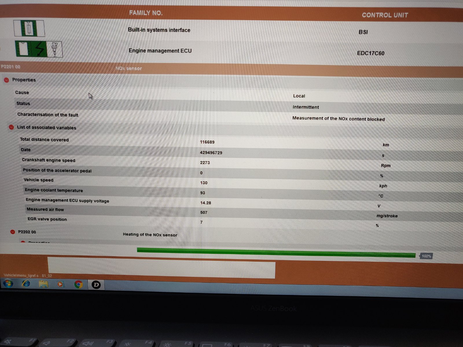

This all started around 20 km after a DPF regeneration. I've tried to erase the codes and they kept coming back. But it wasn't the same codes everytime. After the error codes came on the car stopped smoking from the exhaust. After clearing the codes it's running fine with no visible smoking from the exhaust.

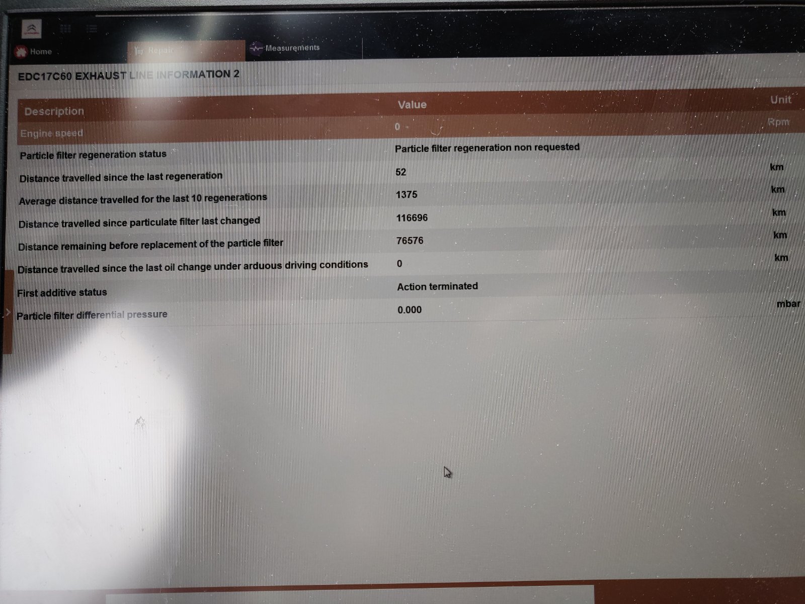

I've read the faults with diagbox and attached them to this post.

The P2201 fault code is to do with the tightening of the NOx sensor. It may also produce other fault codes. The guidance is to check the NOx sensor and tighten to the correct torque.

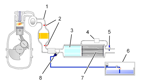

Just a little info:
On your vehicle you have Euro 6.1 Emission Standards. The Urea solution consumption was consistent with the Euro 6.1 emission control standard, but was increased and became variable for Euro 6.2 standards (see second diagram). So your Adblue injection rate should still be consistent. But if the NOx sensor is playing up it may be injecting for longer than is necessary if the measurement data is out.
Diagram of DW / DV engines compliant with the Euro 6.1 emission control standard (Private vehicles / Light commercial vehicles).
Key:
(1) DeNOx absorber.
(2) Temperature sensor.
(3) DeNOx catalyser.
(4) Particle filter differential pressure sensor.
(5) NOx sensor.
(6) Urea reservoir.
(7) Particulate emission filter (pef).
(8) Urea injector.

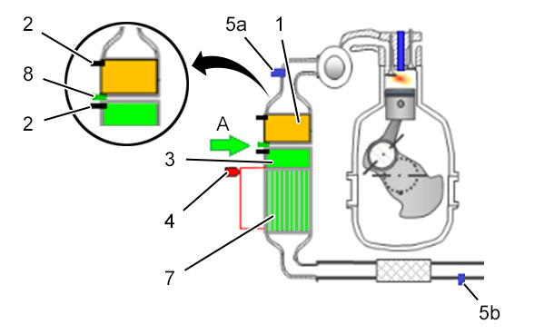

Diagram of DV engines compliant with the Euro 6.2 emission control standard (Private vehicles / Light commercial vehicles).
Key:
(A) Urea solution injection.
(1) DeNOx absorber.
(5a) Upstream NOx sensor.
(5b) Downstream NOx sensor.
(8) Urea injector.
For Euro 6.2 engines, they incorporated an additional NOx sensor upstream of the catalytic converter for more reliable control of the quantity of urea solution to be injected. For the new DV5R engine family, positioning the deNOx assembly (consisting of the deNOx (DOC) absorber, the deNOx catalytic converter and the particle filter) just below the turbocharger made it possible to remove the additive mixing function of the particle filter.
So in my case with the 6.2 Euro standards, the Urea injection is both increased in capacity and is variable to account for different driving conditions.
I noticed last month when I looked in my engine bay and noticed the catalyst and Adblue injector right in front of me!
