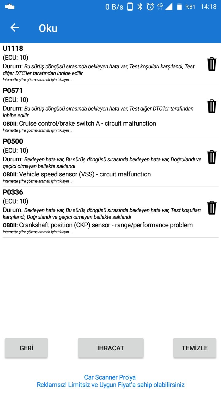

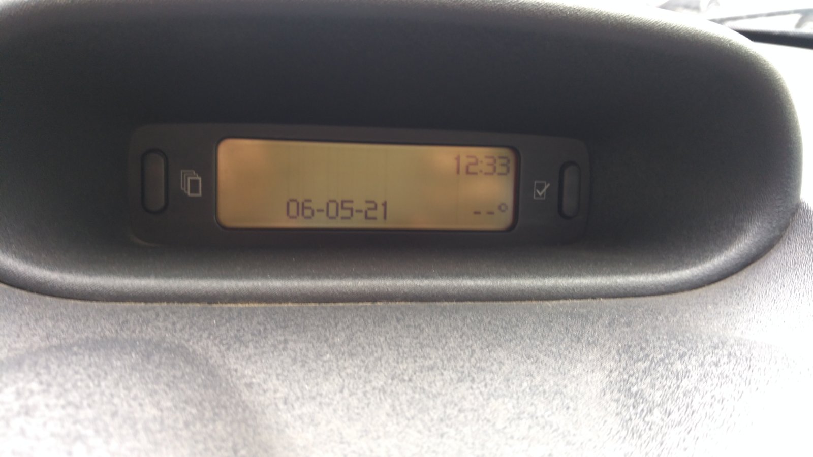

Hello friends, I need your ideas and help again. I have Citroen C3 1.4i Sensodrive 2006. I have uploaded two pictures in my subject. Second one is my console which has to show temperature of outside and amount of gasoline per 100 kilometers but as you see in the picture, there is nothing at all. I think one of the sensors were broken but I do not know which one and where it is. First picture is fault codes of my car. Because of this I need your ideas about location of faults in order to solve problem. Thanks in advanced.

Has it always been like this since you had the car or just happened one day? Have you changed the radio in the car from the original or made any other changes to the car just before this happened?

wheeler wrote: 07 May 2021, 07:23 Has it always been like this since you had the car or just happened one day? Have you changed the radio in the car from the original or made any other changes to the car just before this happened?
No, it has not. The radyo and clutch actuator have been changed. After being changed clutch actuator the problem has occur. But clutch actuator is component of gear. My problem is about temperature and range per km sensors.

If you have changed the radio and it hasn't been fitted correctly there is a good chance this is causing the problems with your display, try disconnecting the radio.
There is no specific sensor for fuel consumption calculation, it is done by the engine ECU based on the info it sees from various inputs & sensors.
