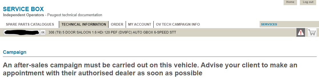

Yep, I thought so - when I put your VIN in, there is an outstanding After-Sales Campaign for your vehicle!
I can't tell you exactly what it is for, but you need to contact your Peugeot dealer and give him your VIN. They will be able to tell you what the work is for. It won't cost you anything - but it could save you a lot in costs yourself, so don't wait - get it booked in now.

Asked service and this campaign about timing belt replacement. My problem is still exist. P02ED and P00BC looks same time in vehicle.GiveMeABreak wrote: 29 Apr 2021, 21:13 Yep, I thought so - when I put your VIN in, there is an outstanding After-Sales Campaign for your vehicle!

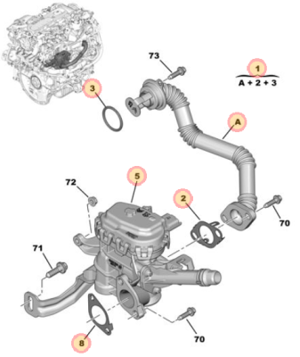

Peugeot 308 P9 (2015):
When I go on a long journey, I tend to monitor for dpf regens (and fault codes) by a mobile app (FAP). Usually the car starts a regen between 12.5 & 13.5g. I noticed that it hasn’t done a regen and now is up to 18g.
So I plugged-in Diagbox to see what was going on. No faults are shown for the EGR circuit until I do the engine management actuator test “Test of the Air Intake Circuit”. This does the test and then shows the result “EGR circuit permeability fault”.
I tried the actuator test of the EGR valve and this showed no faults found.
Over the last year I’ve had previously had the P00BC + P02ED fault codes:
- P00BC inlet air circuit - air flow lower than the theoretical air flow, legislative threshold
- P02ED inlet air circuit - air flow higher than the theoretical air flow, legislative threshold
So looking at this post last year, I assumed that I would need to replace the EGR valve as the two fault codes started to appear quite often (3 to 4 times on a 100 miles journey).
As I hadn’t had time to change the EGR valve, I tried an EGR valve clean via Diagbox (Autumn last year). Surprisingly, after this, I had a long time (a couple of months) without any P00BC & P02ED faults. After that I have had a very occasionally fault during a long, hard deceleration e.g. down a steep hill.
Trying the EGR valve clean operation via Diagbox today gives the result “Unclogging failed”, “communication problem, Response time too long, Restart the test”.
So I’m guessing that I need to replace the EGR valve (or is it likely that it needs a physical clean, or has a wiring issue to it?).
So can someone please supply the part number for the EGR valve and any gaskets that are also required {VIN VF3**************[VIN obfuscated, can be read by forum staff]}

The engine ECU does the EGR 'anti-stick' routine every time the engine is switched off just so you're aware.
(1) Gas Recycling Tube, part: 9803842980, £68.29
(2) Emission Control Seal, part: 9803844580, £29.09
(3) Emission Control Seal, part: 9803843480, £29.09
(5) EGR Valve, part: 9833095880, £405.56
(8) Gas Circulation Module Seal, part: 9804276280, £17.46
Note Seals (2) & (3) are part of the Tube (1), but I've included them separately in case you didn't want the tube.

Hi Marc,
Thanks for the part numbers.
I don't know if you know, but
"The engine ECU does the EGR 'anti-stick' routine every time the engine is switched off just so you're aware."
- Does the ECU also monitor the position/health of the EGR valve, i.e. would it show if the valve was faulty?
I'm asking the question as the valve at the moment is not shown as faulty and the only thing showing during the actuator test was the “EGR circuit permeability fault”, i.e. do I have a blockage somewhere and the valve is ok. Note I have just just taken the EGR pipe (1) off and it is not blocked, but does have significant oily/soot build up around the non-egr valve end. I haven't removed the valve yet as I'll have to drain the engine coolant as it seems to be water cooled and wondering if I should look for blockage in the pipe on the back of the throttle body first.
I have yet to check further as the rain is back on
Any advice would be appreciated
