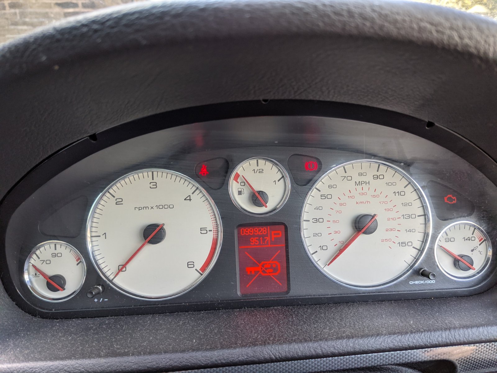

I have a spare key for my 407 SW which does not seem to have any electronic internals. I tried it in the ignition today and the engine turned over but refused to fire, displaying a key icon on the dash. I'm guessing this means it doesn't have the immobiliser transponder either.

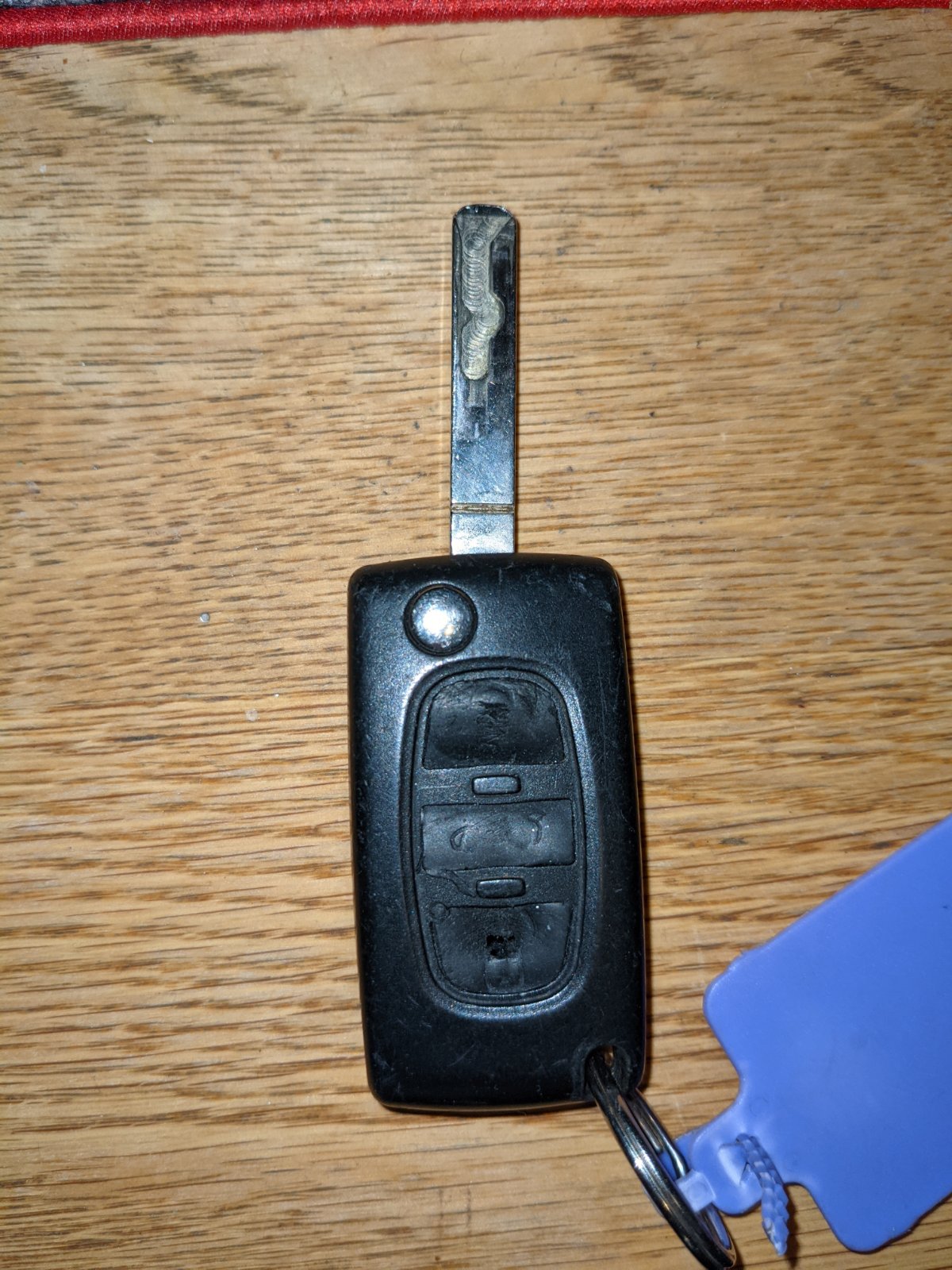

A photo of the key would help.
It's quite possible that the key is a non-remote control type (no buttons to lock/unlock the car) but does contain the programmable chip to allow starting. This chip by itself is very small and with no electronics locking/unlocking, can be overlooked.
And that, in turn, the pairing between car and chip has been lost. You'd need a Diagbox to check this out re-pair if true.

Thanks for the reply. Here's a photo of the key itself - it looks like it did have some internals at some point in its life:

If you just wanted to get it to start the car the cheapest option is to get hold of a new ID46 chip & stick it inside the casing with a bit of blue tack & program it to the car, if you want also remote function too then just buy a replacement remote key, the can be bought cheaply enough from China. You can switch your old key blade onto it so you don’t need to have it cut.
To get it programmed either way you need your 4 digit security code.

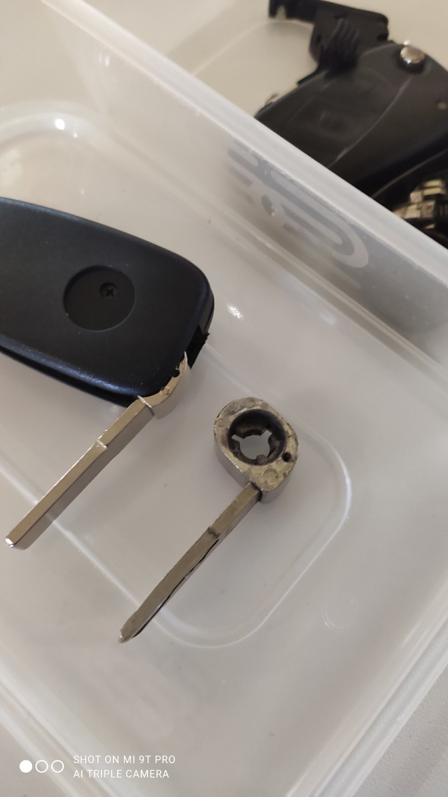

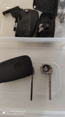

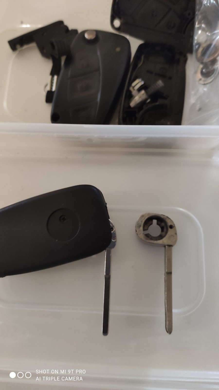

Gettting a replacement fob and changing the blade is not straight forward. There are a few variations of press button centre and they won't swap. Unpinning the blade from the centre and trying to exchange it on its own doesn't work easily either, some tangs are different sizes and the pin is sometimes in a different location. They all look similar until you try it.
Dormouse
- Posts: 2145
- Joined: 15 Apr 2021, 14:32
- x 696
Re: Options for Replacement Key
In these pictures everything looks the same but this blade will not fit the new fob. I have done several fobs and rarely get exactly the same blade and push button centre with either new or secondhand fobs. Notice the plastic box with spare bits - none interchanged with the new fob shown.
