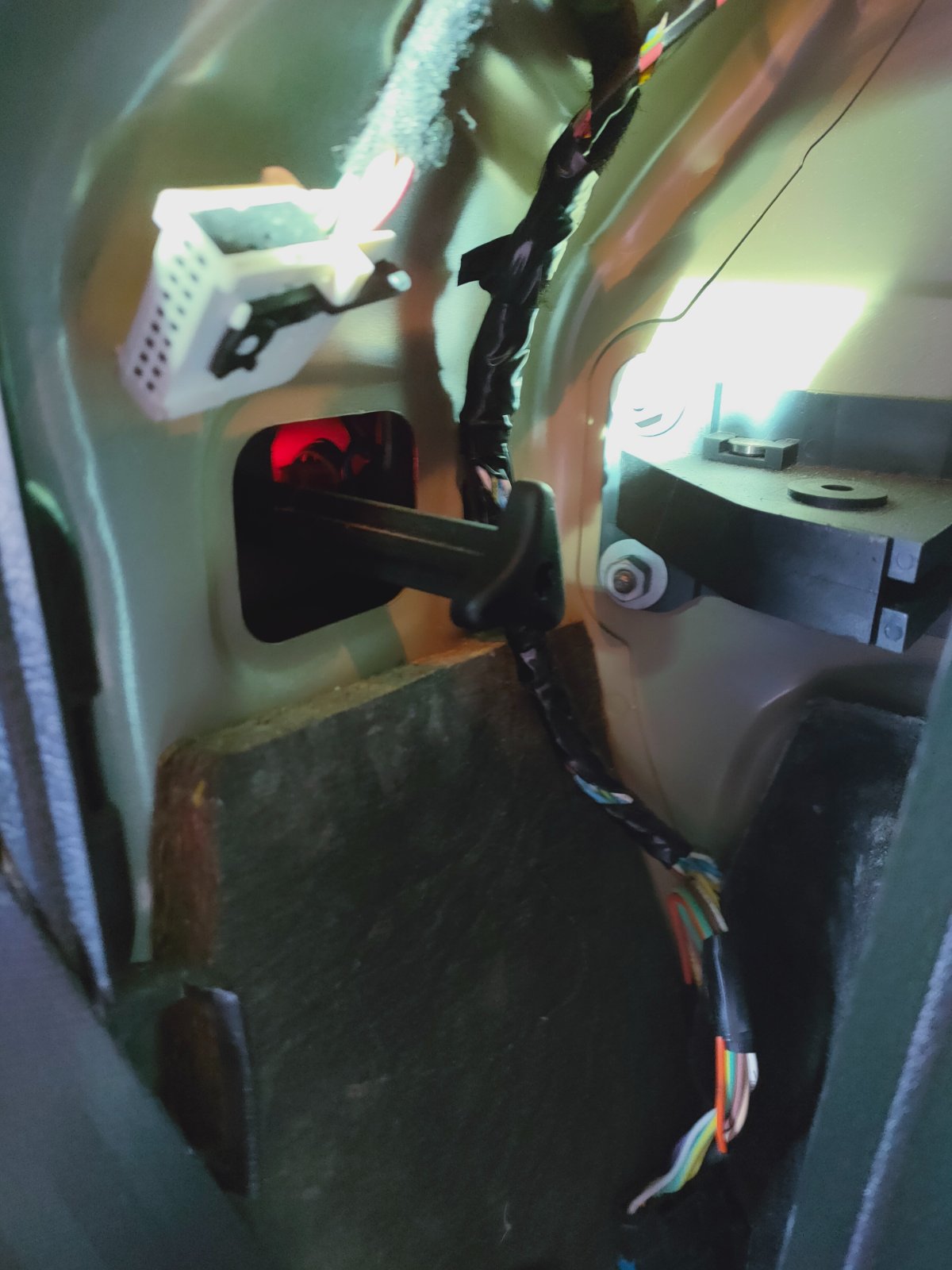

I've been cleaning the plastic trim in the 807 as the previous owner left it in a grim state..
When Poppin off the rear right trim (where the rear right seatbelt retracts) I came across this clipped wiring ... Is it something I need to be concerned about? And secondly any one have any idea what was part of this wiring loom?
Wiring loom snipped
Wiring loom snipped
There is also a rouge red wire that's been snipped too..
Any advice and help appreciated.

Possibly the remains of towbar electrics by the looks of it..
Definitely needs tidying up as it has a potential to cause short circuits and odd behaviours...

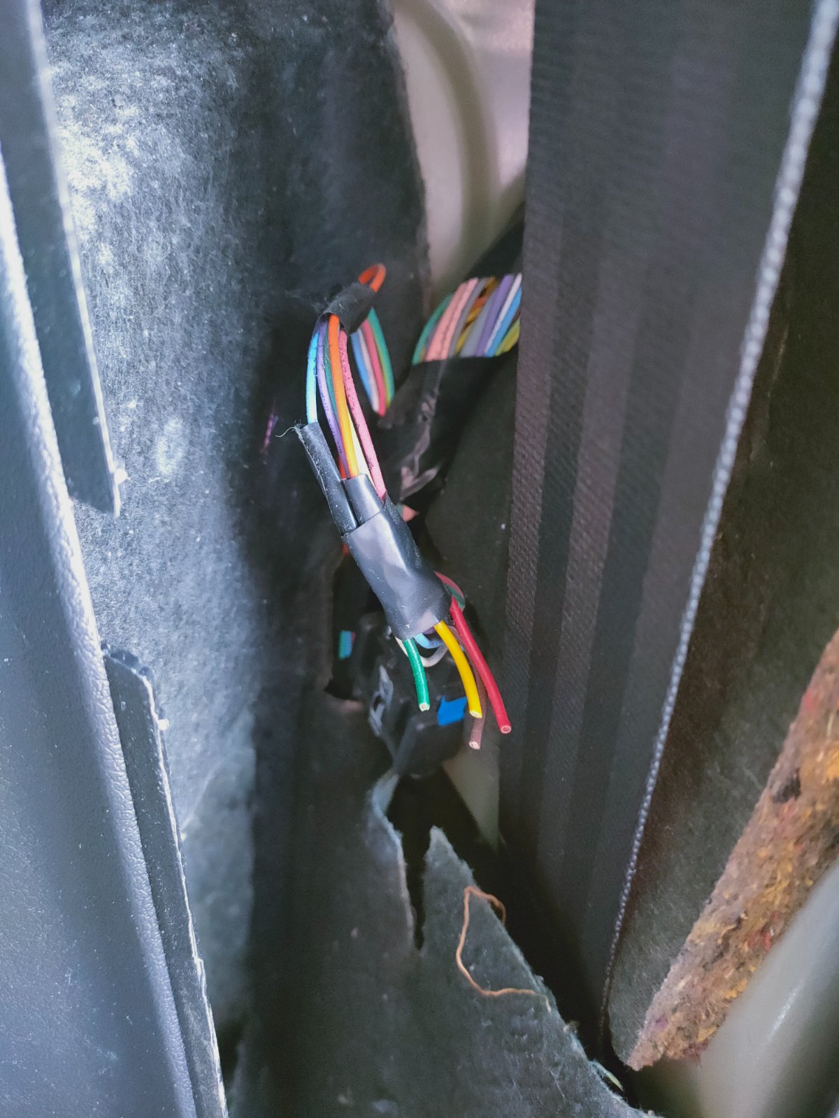

Going by the colours and the number of wires it looks like snipped towbar wiring. I would hunt around the other side of the car to find out if there are any more.

This is the rear left of the car.
Wiring rear left car

I would try to find out how all the snipped wires are joined to the harness. - have a look under the bits of tape. The bare ends could be the least of your worries if there are any horrors under the tape. Whatever, you would be wise to seal off all wires individually to avoid any chances of shorts.
