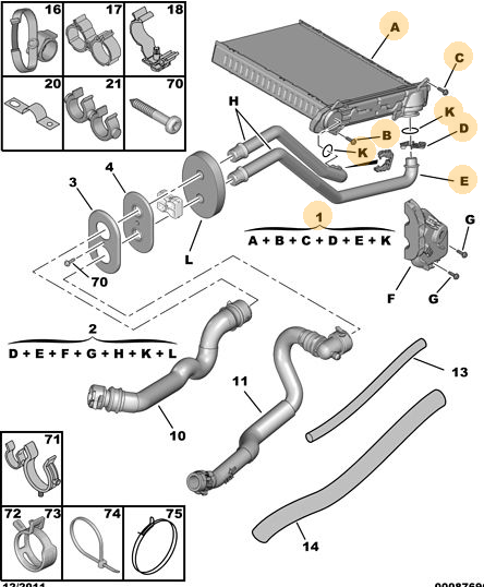

DanCD wrote: 02 May 2021, 17:00 Hi,
Could anyone give me the part number for the heater matrix of my car? CITROËN C4 II Hatchback 1.6 VTi 120, 2011 reg.
Cheers,
Dan
Hi Dan
Part for the Heater Matrix on your C4 is 6448W8. Item (1). It is priced today at £226.21 inc. VAT from Citroen and includes all the items highlighted.
