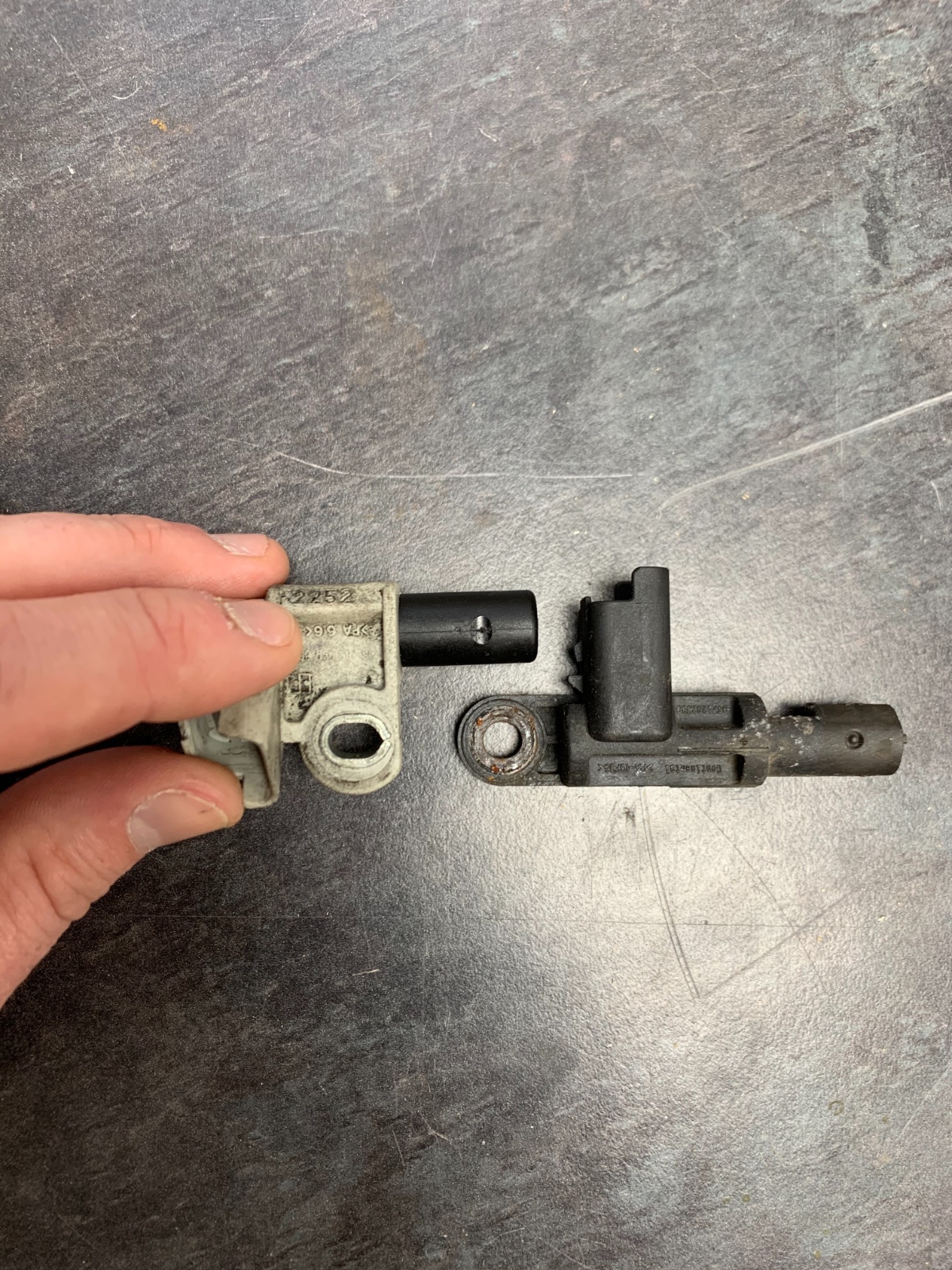

Im not sure 100% on this exact engine if this one is adjustable but most of the PSA HDi engines i have dealt with are. If you look at the sensor on the left (from a DW10 engine) you can see that the mounting hole is slightly elongated to allow for adjustment. The one on the right (from a later Relay van i think) is not adjustable.
Its the first thing that springs to mind based on what has been done to the car. The fact it drove in & is now not working after having work done id be 95% sure this is a human error fault.

I am sure it is a human error, Sensor on this has a lead that is part of it and doesn't look to be adjustable
