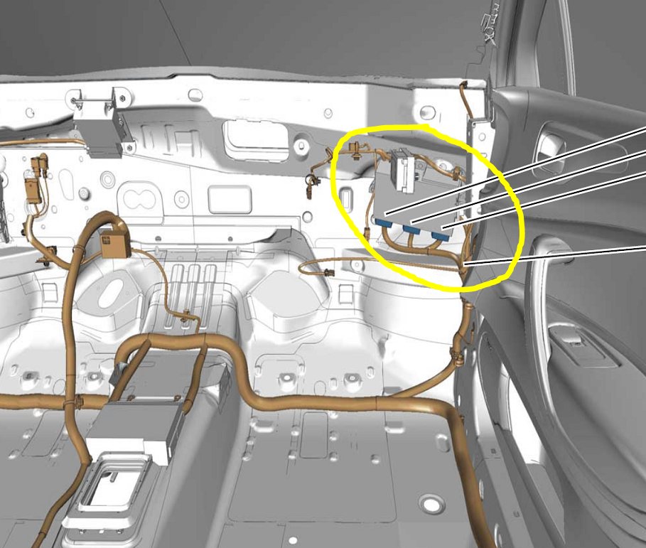

Hi Marc,
Do you know where the amp is in a Citroën C5 X7 (2012) with Navidrive 3D NG4??
Thank you in advance!
J.

Re: Equaliser Amp Location
The Equaliser Amplifier (if fitted - as this was an option only) is located front left in the dashboard as I have circled in yellow:
