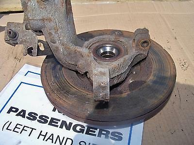

Hey I’m in serious need of a hub due to the wheel bearing circlip being seized in place and I was just wondering if I got a berlingo hub would the rest be the same,or would I have to change trackrods etc,many thanks

I would say yes, the photo is a Berlingo and the parts image a 306. Both have pinch bolt fixings to the strut and lower ball joint.
The only problem you may find is the pin on the lower ball joint is a different diameter, so watch out.

Hey many thanks for the quick response I’ve got the hub on and the ball joint was luckily the same but I changed the two outer track rod ends and they don’t seem to let me screw them in enough the trackrod ends are sperious parts,do you know if that would be the reason?
