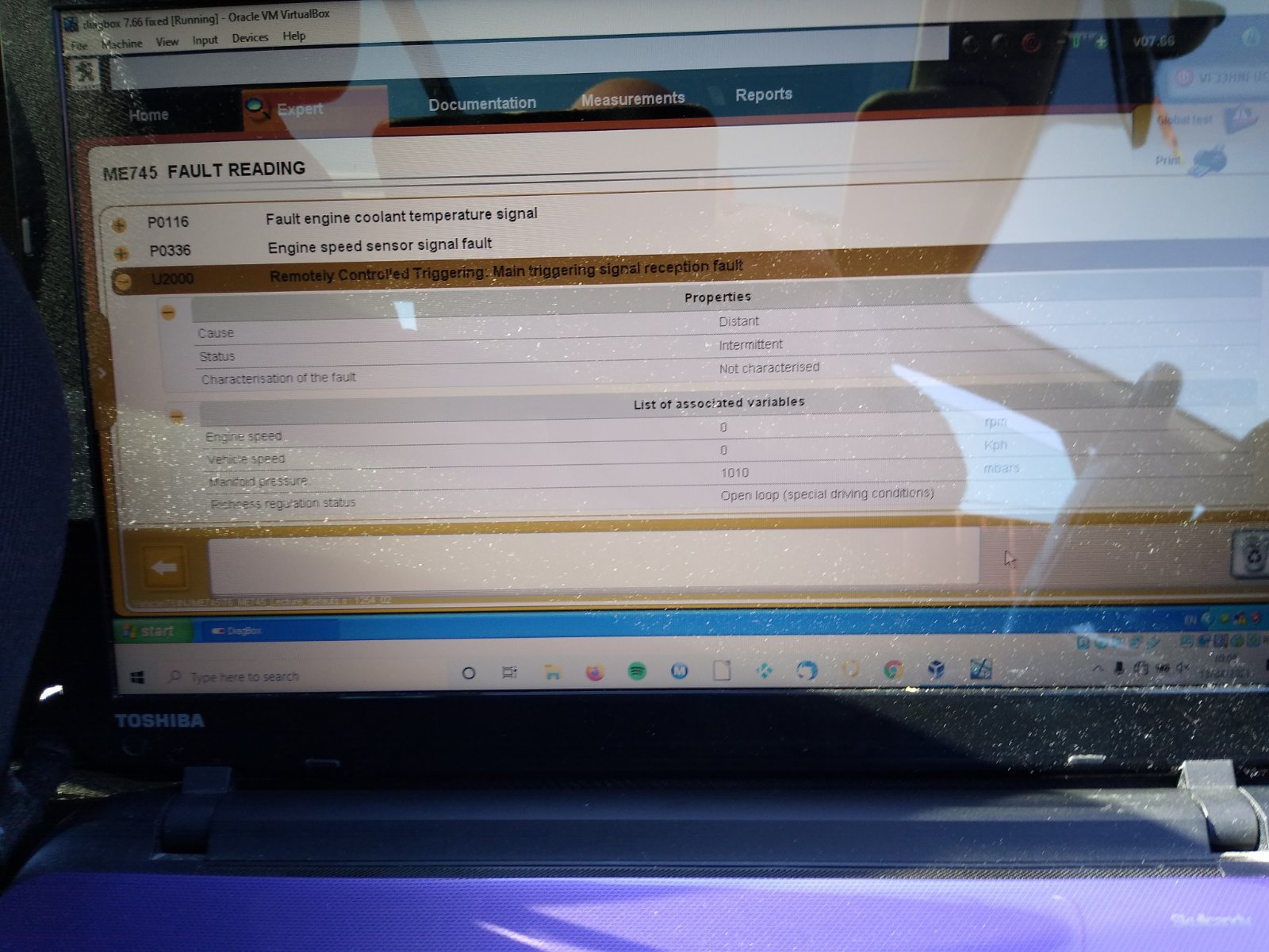

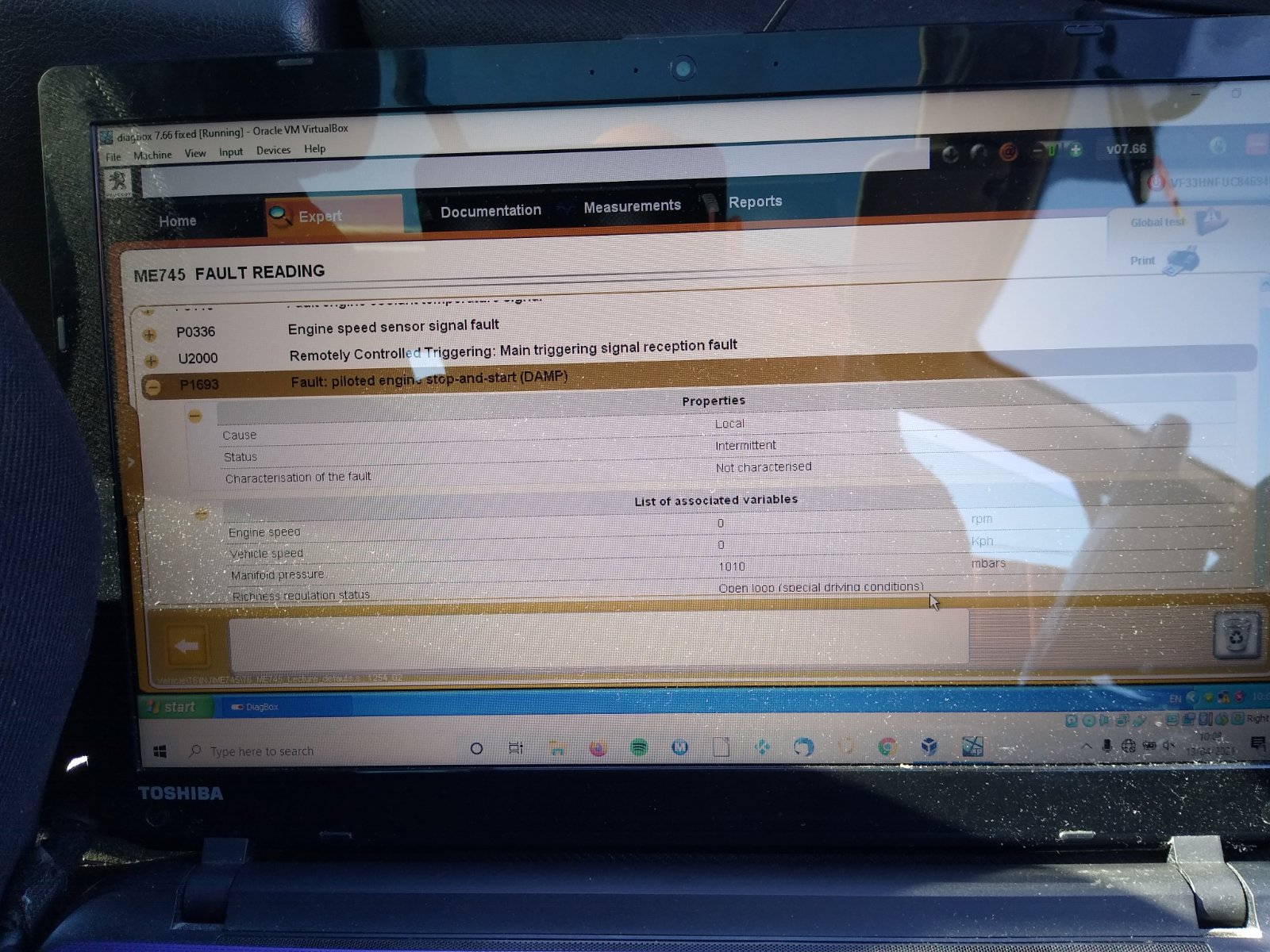

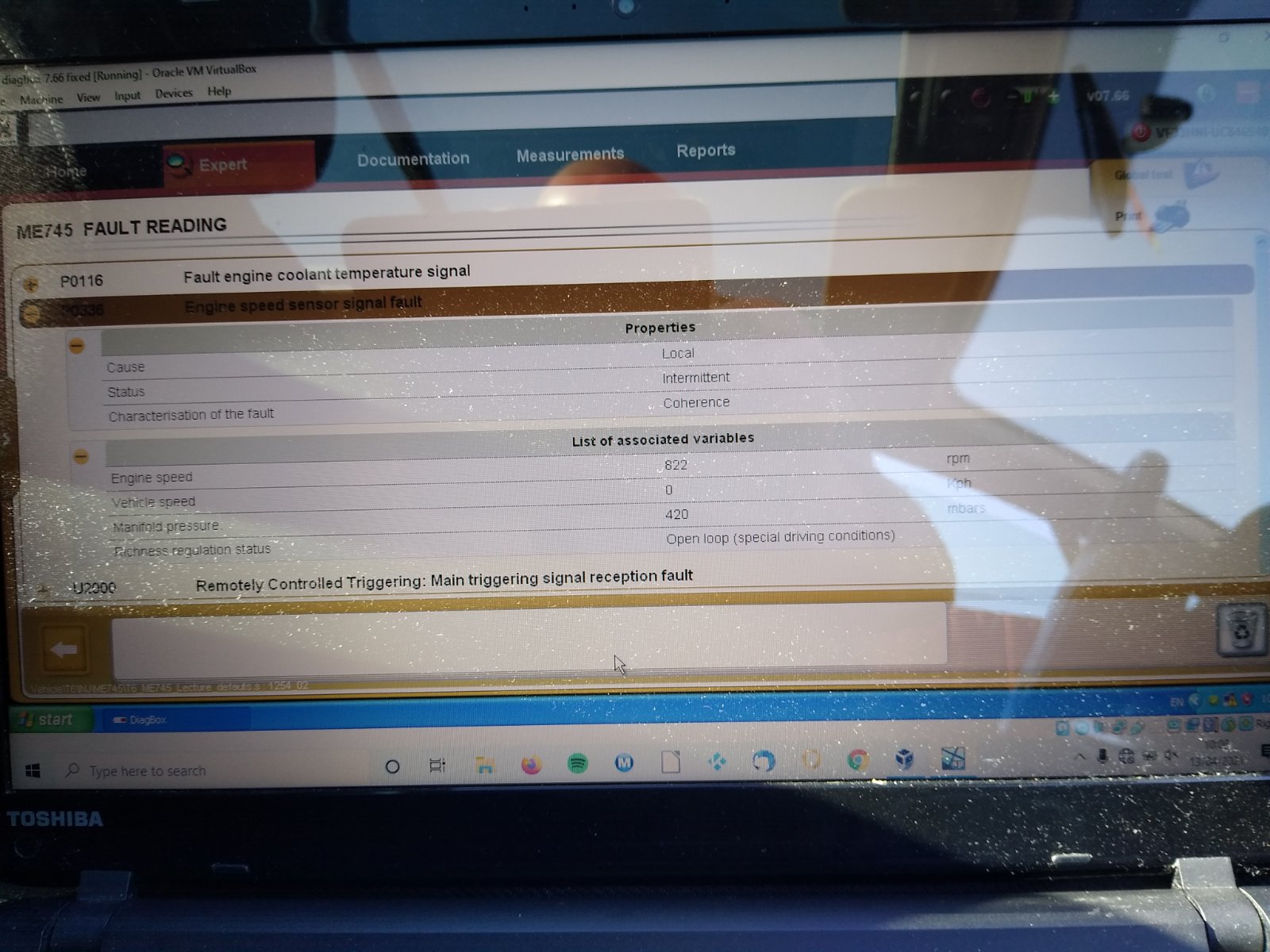

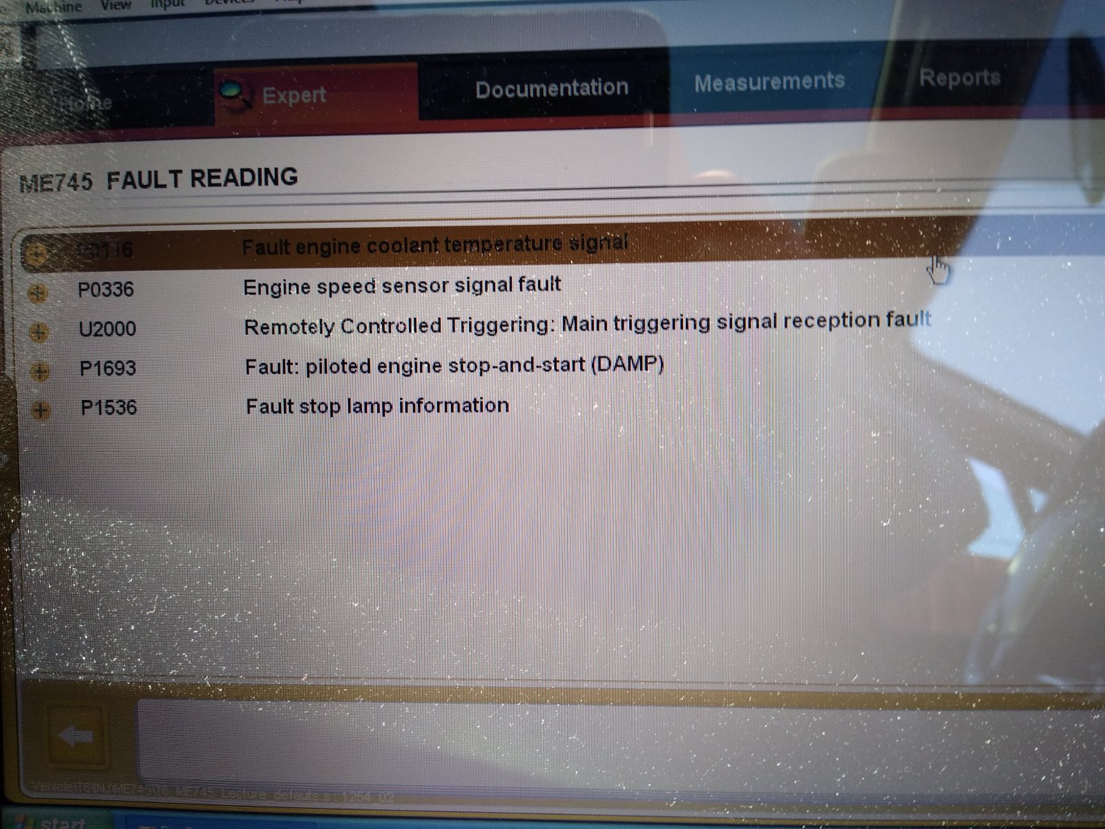

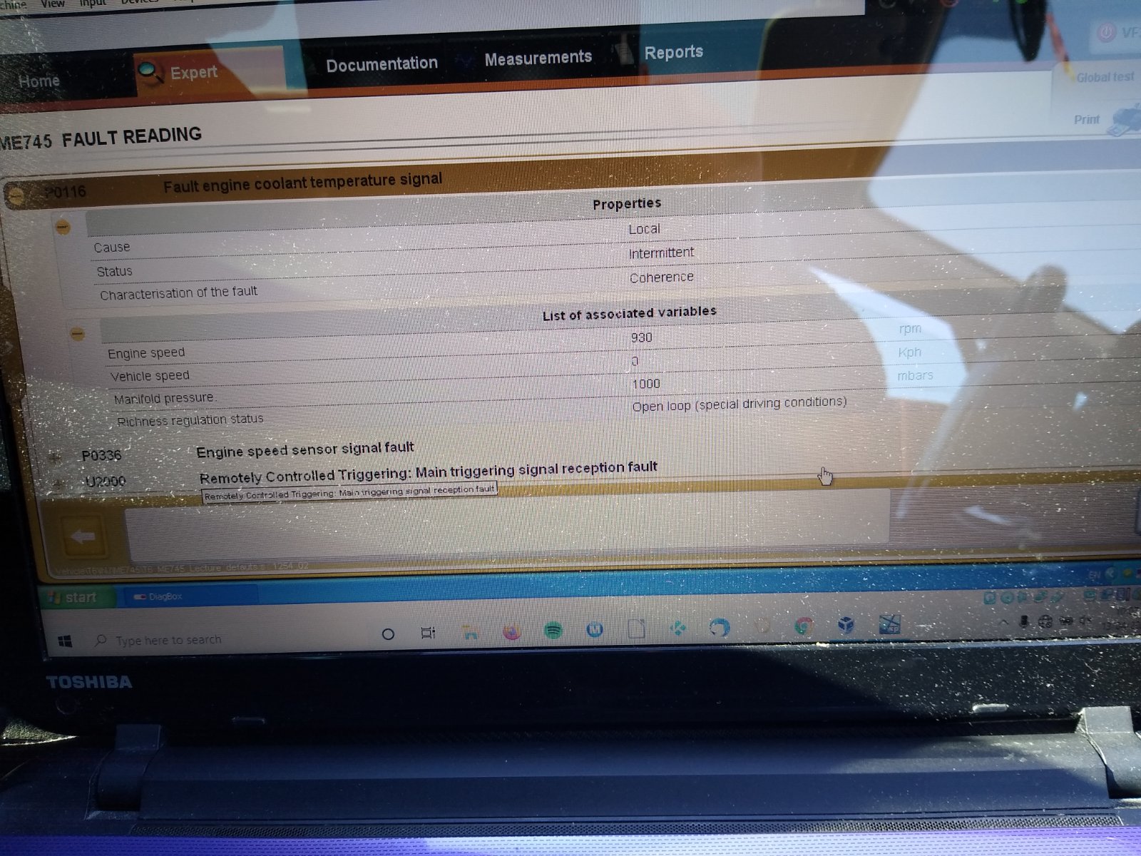

My daughter's having an intermittent problem again with her car - very similar to problems she had a year ago.
Faltering then cutting out at idle, depollution warning and EML on.
Diagbox codes:
Clear the faults and it's OK for a while, then the issue returns.
I replaced the crankshaft position sensor in April last year, non-OEM so I'm wondering whether this might be suspect.
Also replaced the coil pack last September.
