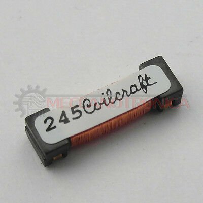

Hello & Good morning,
I'm Benjamin, I'm french and just registered a minute ago on this forum.
I have kind of the same issue here i think my car key is dead. The car will open and lock remtotely but won't start the engine / the vehicle, so I changed the key battery but still, the car do not want to start.
I guess it's not the transponder (the coil which act as an antenna if i understood correctly) but probably the RFID chip who's either dead or uncoded i don't really know to be honest.
Anyway i was thinking about ordering a new car key (it's a 0523) however i do not know if this work in ASK or FSK. I've seen 0523 car key in ASK and FSK...

So for me this has nothing to do with the car but more the key.... I'm not sure I understood all your explanation but I also thought about the coil.... because it is quite exposed on a 0523 circuit board... but the coil seems ok with my naked eye ... no trace of damage or such...
But if I summarize correctly there are 4 main electronic parts: the transmitter, the transponder, the HF module, and the coil

That's not the coil that I was talking about. That's the antenna (coil) for a PCB transponder. I don't want to make this thread more complicated but you can get keys that have the transponder as part of the circuit board or the transponder is separate.
To my knowledge the genuine keys have a circuit board for the transmitter and a separate ID46 transponder 'chip'. I have only seen the Chinese knock-off keys use the "on PCB" type transponders with the discrete coil. So I don't think your key is original, but....I could be wrong.
