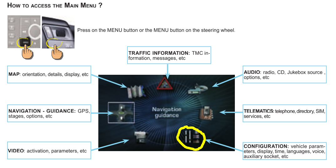

Peter has an RT4 system Colin - completely different in operation and interface to your MyWay.
Peter - press the MENU button on the RT4 and then navigate to the Configuration Menu (should be the last one on the right side) and from in there, you can set up various options, including the voice control and volume levels.
