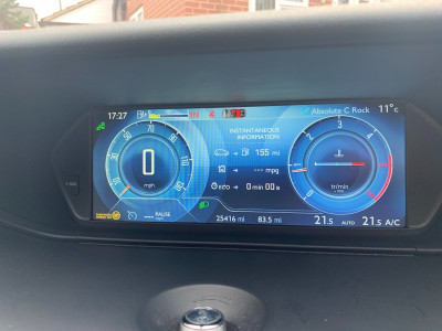

The HD screen's virtual speedo dial is on the left-hand side. I can't work out if this is expected on a Right-hand drive (UK Spec) vehicle or something is not right somewhere?

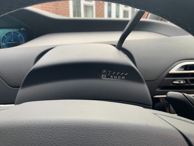

It's an EAT6 / Auto transmission. I am expecting the PRNDM under the virtual speedometer dial to reflect the gear selection, I do not see that at all in the HD LCD.

On this display the screen is split into 'thirds'. The first third on the left is permanent, but the display on the other two thirds is configurable and can be personalised. It's all in the manual on how to do this, but if you don't have one - let me know.
