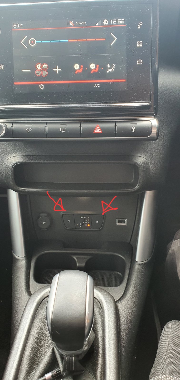

Does anybody know what the he'll these buttons do?
x 6950
Re: Citroen C3 Aircross
I suggest you have a read of your owner's manual for a more detailed explanation.
The are special operational modes of the Automatic Gearbox. The 'S' is for a sportier mode (gear changes are longer apart) and the * is a snow programme mode to help with slippery surfaces.
Fixitchap
Posts: 2
Joined: 13 Jul 2023, 12:55
Unread post by Fixitchap »
Thank you, they don't seem to do anything though, and when I press them there is no acknowledgement from the car displays.
x 6950
You won't notice anything with the snow programme because the road isn't covered in snow or ice. In this mode the system dampens the power transmitted from the gearbox to the wheels to help prevent wheel spins - but there will be a difference in Sport Mode. The system monitors your driving and adapts the gear changes accordingly - it does this by allowing the engine to run at a higher RPM before gear changes. But if you are only driving 'normally' then it may not make much difference as the systems knows this from all the sensors (Accelerator / Wheel speed sensors etc).
