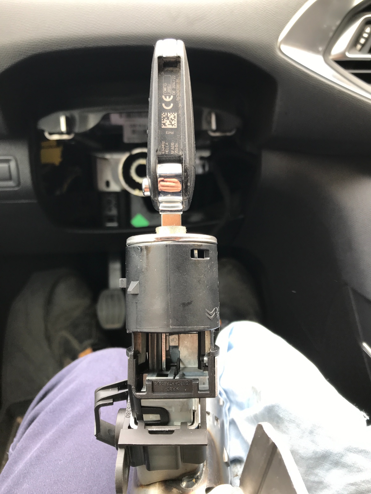

I then tried to turn the key to start but the key wouldn't turn. It just starts to turn but stops as soon as the steering wheel lock is engaged.
I have tried all methods found on the I-net: tapping the key, jurking the steering wheel, WD-40... nothing works.

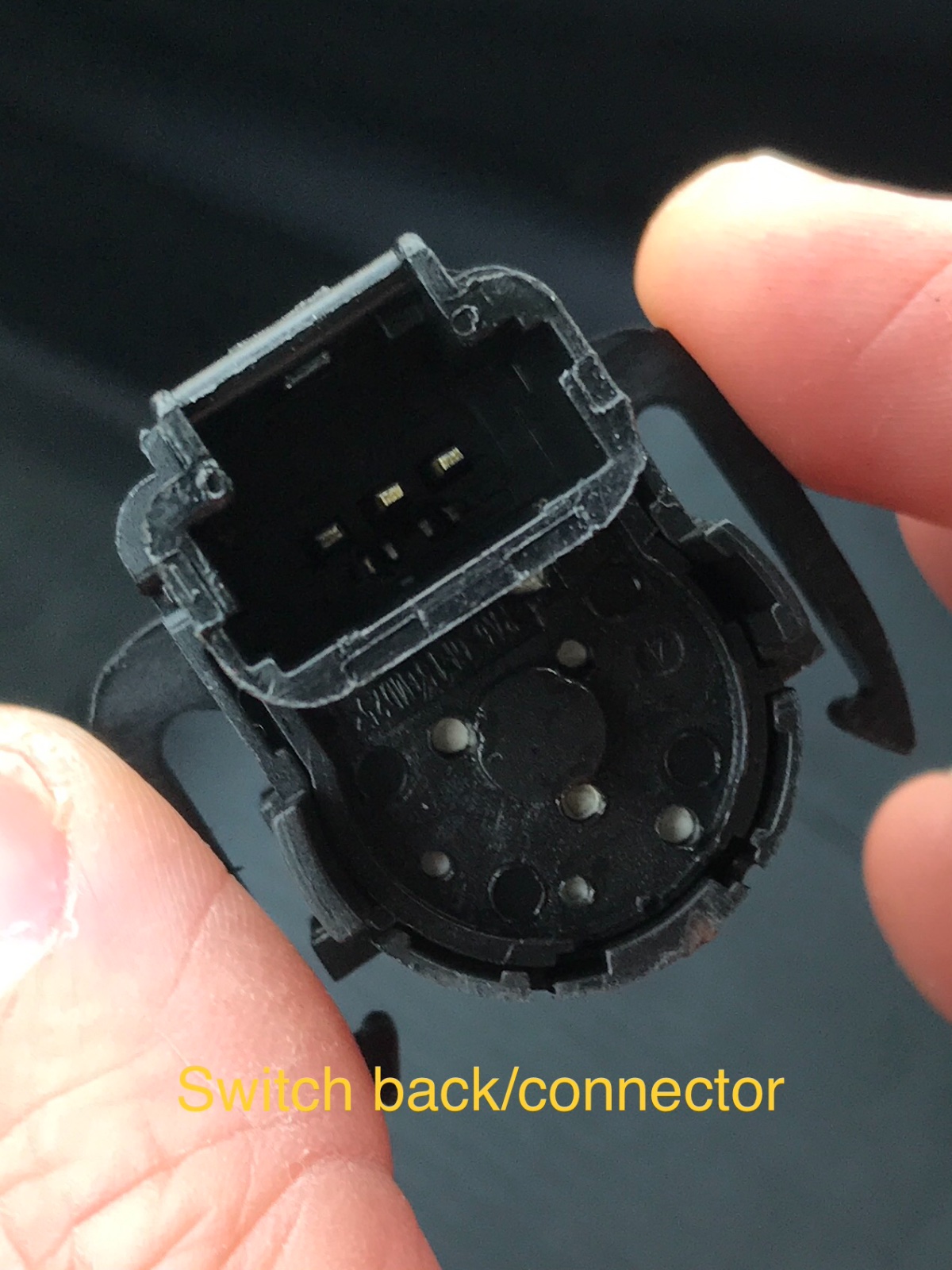

So after unmounting it all again i have take a few pictures to illustrate.
All electronics seems to work. I have even managed to start the car with the key in the barrel by turning the switch behind to put it in start.
It seems to be a mechanical issue with the barrel and the steering wheel lock.
Is there an anti-theft clip or similar that blocks the barrel if the switch behind is removed?
I can see a spring or a pin that seems to move when you remove the switch.
