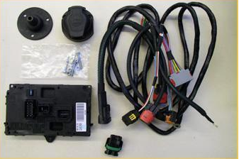

Ok, I’ve been out, so will pop some details up later, but there is a kit with the relay unit for about £174. Obviously you will have to fit it, but instructions are supplied. I’ll pop some info up later for you.
x 6956
Re: Berlingo Tow-bar Question
Ok, so part number for the kit is: 1613715880, which is for the electric kit and doesn't include the towbar itself of course.
Description
  • 13-way towbar harness, for connecting ball tow hitches.
  • This harness takes account of the features of the vehicle, thus ensuring safety, reliability and simplicity of fitting.
  • Simple connection using the interface connectors identical to those for the vehicle.
Technical Characteristics
Main harness delivered with:
  • Cross-over harness for fitting on a vehicle not pre-equipped back to the BSI
  • One BSR EV
  • One 13-way socket and its fixings;
  • Fitting instructions
Notes:
  • Incompatible on vehicles in Floor Cab version.
  • Can be fitted on vehicles from start of production.
  • Incompatible with electric vehicles.
  • Not compatible with vehicles with LED lighting (won't detect blown bulbs)
There is a 13 page colour fitting guide supplied. If you want the fitting instructions to look at, let me know and I'll email it to you as a PDF so you can see what's involved.

Crumbs :shock: £174 seems a lot of loot for some wires.... I take it that I'd need to swap out the BSR for a version that will operate the trailer lights.
How did I manage to wire up my wife's car for around £15 and everything works beautifully? 8-[
Reason: Removed Previous Post Quote
Has anyone seen the plot? :?
x 6956
The BSR is the trailer unit included in the kit as you can see (the black box), so you won't necessarily even have this to start with.
