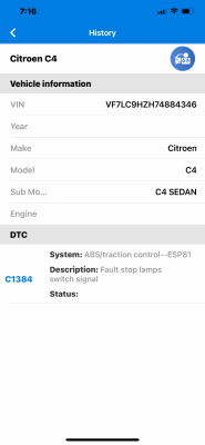

Where do I start lol so had the abs esp fault come up scanned on Autel Scanner says brake switch fault
So changed out the switch with the adapted harness as well and made no difference light still comes on and dredded gongs 😮

Fault code
Fault code

Hello fella whats it on? Have you checked its not a brake in the wiring? Tested the push button attached to the pedal? Just noticed the picture 🤣 check the bulbs and holders for corrosion I've had that fault on two different vehicles in the past.
