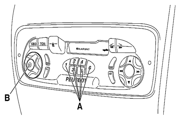

If it's like this one, instructions below - but note the lock out times! So before starting at the beginning, check the last section regarding 'Code Entry Error' - as you may need to leave it before attempting code entry again.
(A)Pre-selection buttons.
(B)Radio On/Off button.
Entering the code:
Switch on the audio equipment(B)
CODE appears on the display for 3 seconds, which indicates that the radio is protected by a code
The radio then changes to requesting a code and - - - - appears on the display
Enter the 4 digit code number using buttons 1 to 6 (A)
Example: Code number 5345:
Press buttons 5, 3, 4, 5, in succession
When the fourth digit has been entered correctly, the radio starts automatically
Code entry error:
Entering the code:
Code entry error:
- The radio will lock for a period of from 5 mn to 1 hours after the fourth incorrect attempt
- To unlock the radio and allow a new attempt to enter the code, leave it switched on throughout the waiting period
- If the radio is turned off during the waiting period, the full original delay will restart when the radio is switched on again
- If there is an error in entering one of the first three digits, do not continue with the operation, switch off the radio to prevent it locking

Huge thanks Marc.Silly question but does the ignition have to be on the 1st click(just red battery light on dash) when resetting the code.
- x 6956
Re: Blaupunkt 2040 code.
It doesn't mention that - but so long as the car isn't going into economy mode, you should be able to do this with engine running or off / as long as the radio is on.
