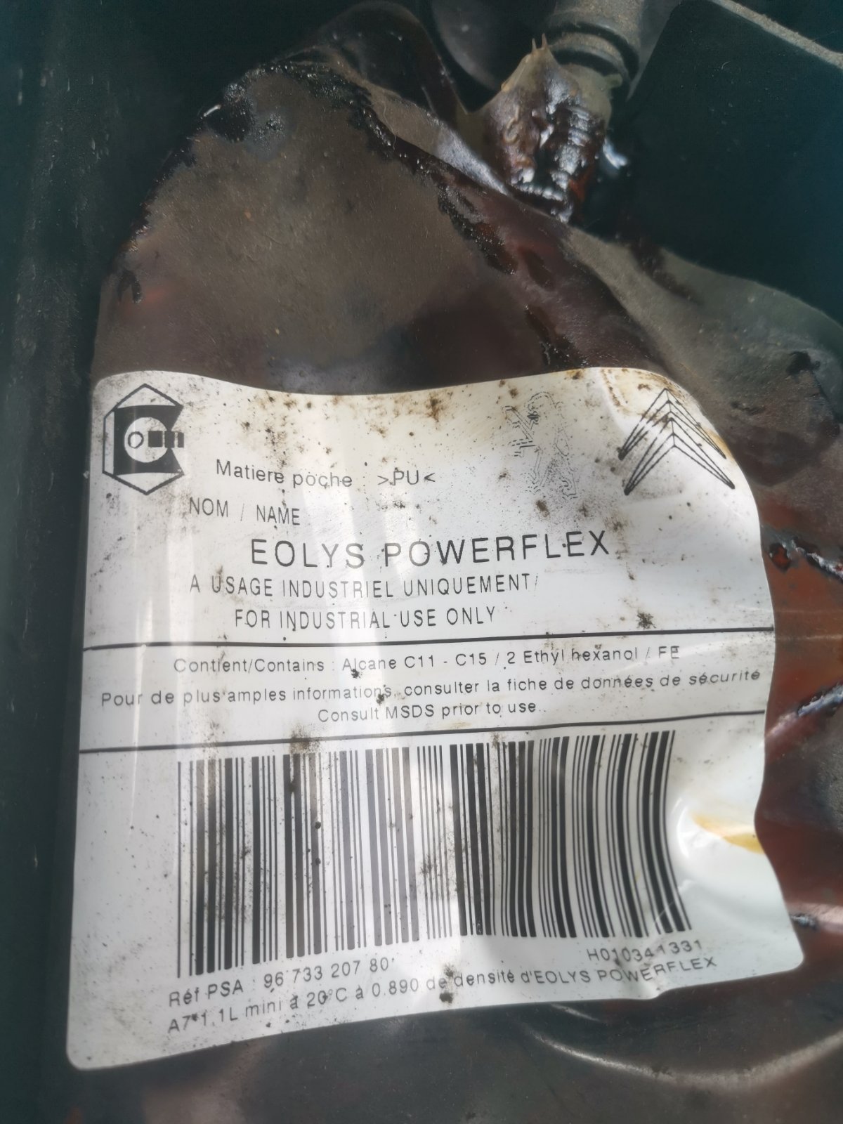

My dad's citroen c3 picasso 1.6hdi 90 bhp 60 plate has been leaking. I removed the eolys housing and the pouch has been leaking. I can't see where but it's pouring out.

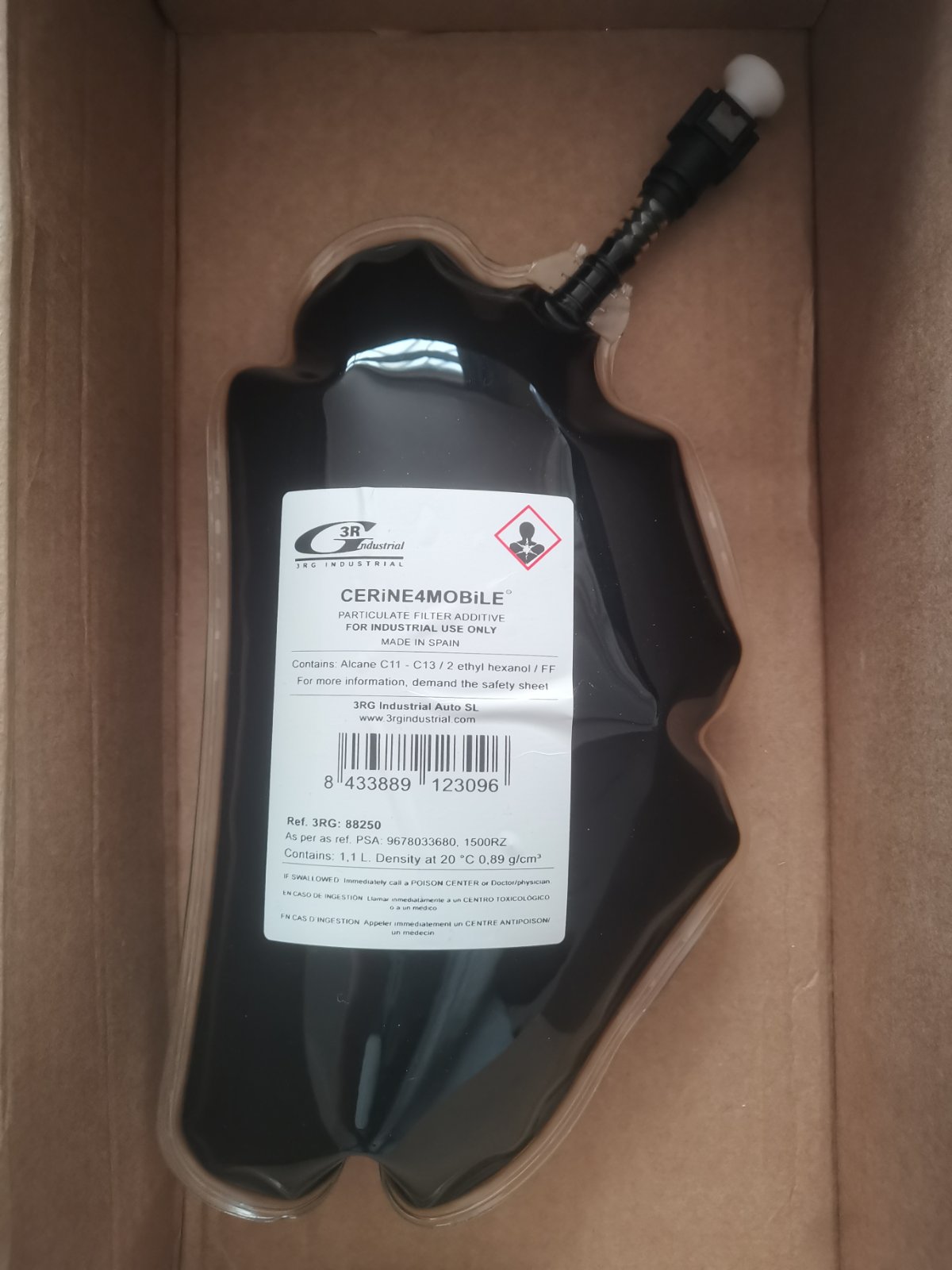

I have been looking for the part but can't find the specific part. The part number on the bag is 96 733 207 80. I order what I thought was the right part but the contents are slightly different it has c-11 - c13 instead of C15 with a part number 9678033680.
Does anyone know if I can use this bag, if not where can I get the right bag.

As long as it is a 1.1 litre pouch and the same shape, and says 'Powerflex', you will be ok.
Part numbers can change and the sizes of the pouch can be different. The Eolys fluid also changes over the years, but use Powerflex and you'll be fine.

It's the same shape and 1.1l but doesn't say powerflex.

I can't help you with that as it's not a PSA brand and it doesn't say clearly what it is.
Stick to the same part reference of the old bag which should guarantee you have the correct type and return that one.
