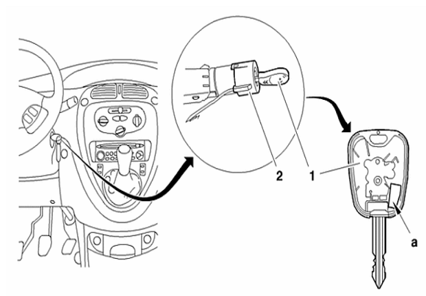

In this case, if the locking / unlocking is fine, then it is very likely to be the transponder aerial on the ignition barrel that is faulty and not properly energising the chip in your key / fob, which can prevent recognition and transmission of the handshaking data to the BSI and Engine ECU. This will in turn prevent the car from starting. Incidentally, does your ignition barrel feel sort of loose - does it wiggle a bit with the key in when you turn it?
Often having lots of keys and weight on the car key ring / fob causes the barrel to weaken and become loose as the car is moving about and over time wrecks the unit which can damage the transponder aerial that is built into the ignition barrel. These can be replaced though. It's always best not to have heavy keyring fobs or loads of keys on the car key-ring to avoid this.
Pop your VIN up so I can see which type you have as there are 2 possible types depending on Electrical Architecture:
If it's the BSI Comm 2000 variant, then the transponder part looks like this (item 2): The wiring may be worn / shorting - hard to tell for sure without further testing / investigation though.

The aerial is just a very fine coil of copper strands, they can go open circuit when warm then be ok when cool down, I have changed loads of them over the years for this fault, admittedly pre com2000 vehicles like Saxo, Xantia & early type picassos. It can be quite a difficult component to prove is faulty (especially when intermittent) without replacing it with a good known one.
