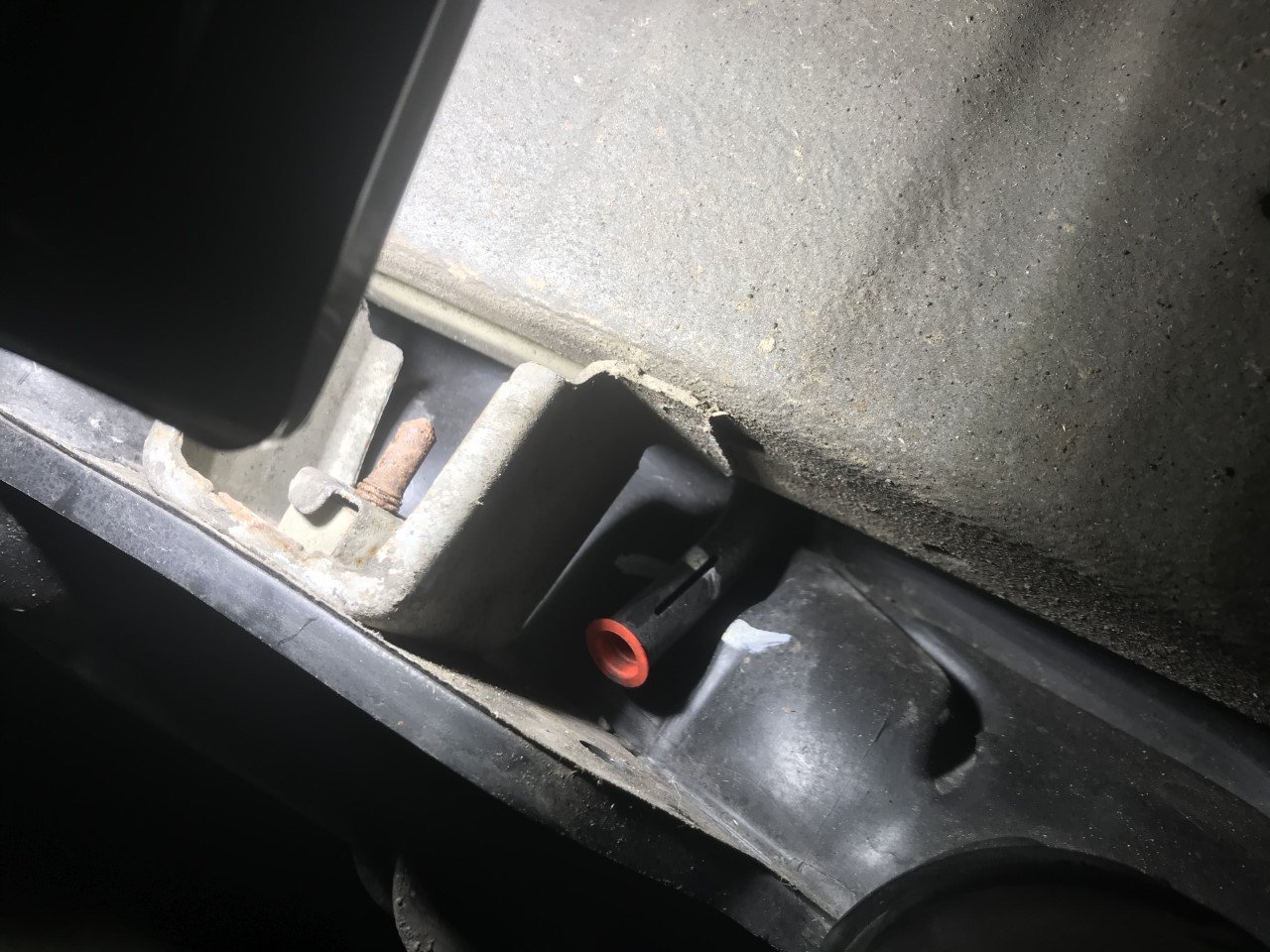

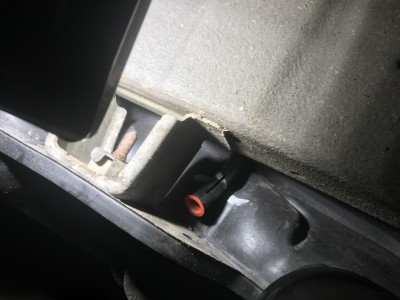

I'm fitting a diesel heater into my Citroen dispatch 2014 and wondering if the picture below is an auxiliary fuel line which would save me dropping the tank to put the diesel heater fuel line in.
The capped pipe is sitting just above the tank.

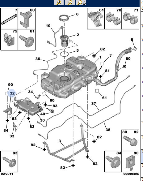

The schematic from Citroen doesn't seem to help much, unless it is part 10 but I think that may be an electrical connector.

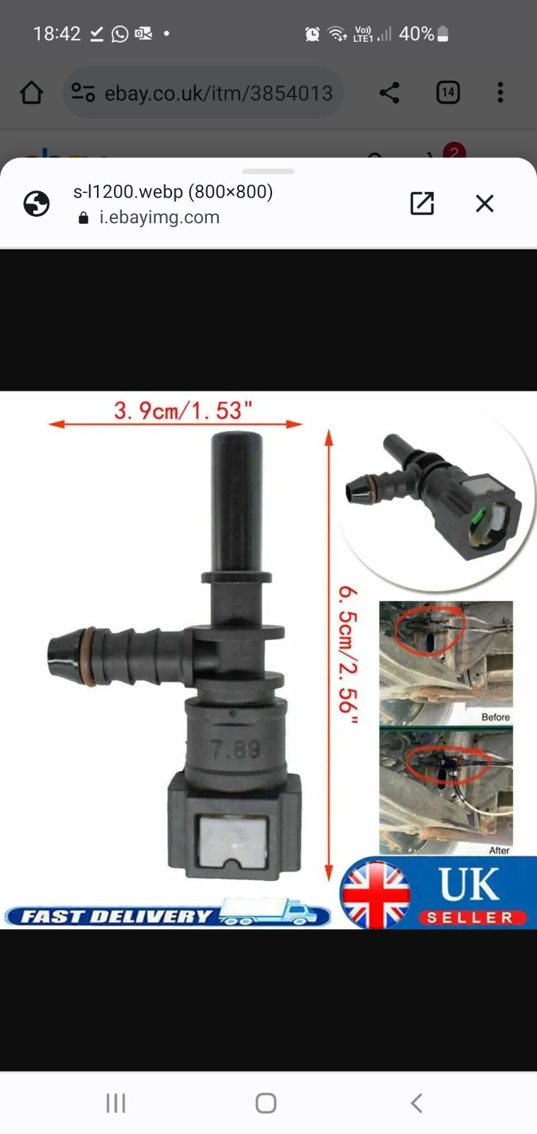

I dropped the tank and made a hole through the top of the sender unit. That's a right pain. Today I found that there's a t piece for vivaro vans that fits the diesel line qui k connects and has a barb off the side. https://www.ebay.co.uk/itm/385401300022
That would probably have been so much easier! I'm hoping I don't need to do this again, but if I do I'll be spending 7 quid on one of those !

As a side note i have replaced in tank fuel pumps on diesel PSA cars & sometimes when the new (dealer part) comes it has a capped off outlet in the top of the sender unit for the auxiliary Webasto heaters.

The Expert/Dispatch 2 litre diesel in tank unit is a guage/sender only - no pump, and doesnt have any capped or extra outlets. I hoped it may have, but there's nothing there.

Q1: @tmead does that Diesel Heater Return Fuel Line T-piece fit the Citroen Dispatch fuel lines?

I dropped the tank and drilled a new hole through the top of the sender jnjt to fit the pickup. Theres no access through the floor.
I don't know if the tap off piece I was told about would fit, but it's only a few quid, so if I had to do the job again I'd get one and try it. Thatvwoukd be way simpler than dropping the tank. Even with less than a 1/4 left nits still really heavy and awkward to maneuver.

Just to be clear i've never seen the capped outlet on the original fuel pump fitted to the car, i was saying that when i have replaced them in the past with a new dealer part the new pump/sender unit has come with a capped off outlet. Almost like they supply the same part now regardless if it has a factory aux heater or not to save on stocking 2 different parts as the one with the extra outlet can do both.tmead wrote: 03 Oct 2023, 13:53 The Expert/Dispatch 2 litre diesel in tank unit is a guage/sender only - no pump, and doesnt have any capped or extra outlets. I hoped it may have, but there's nothing there.
