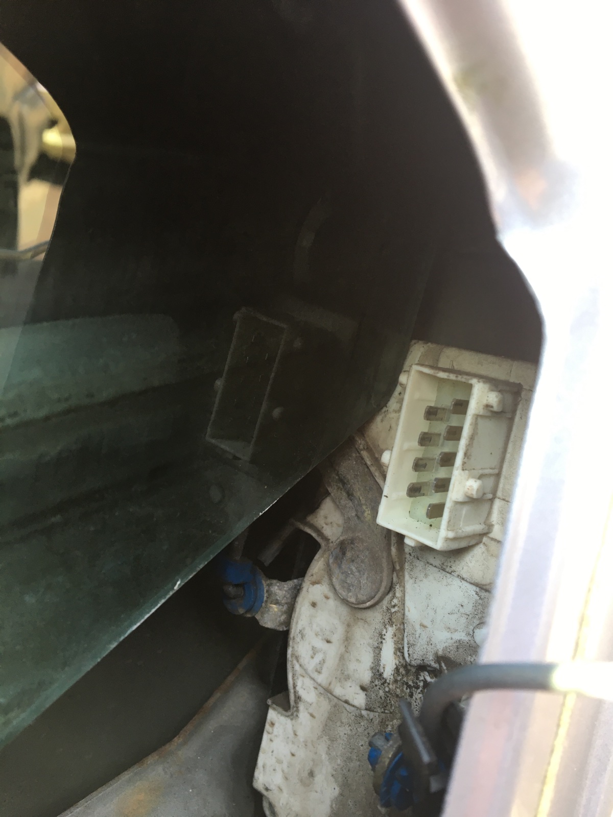

Also, when trying to lower the door glass to the 2/3rds position it fouls the central door locking module.

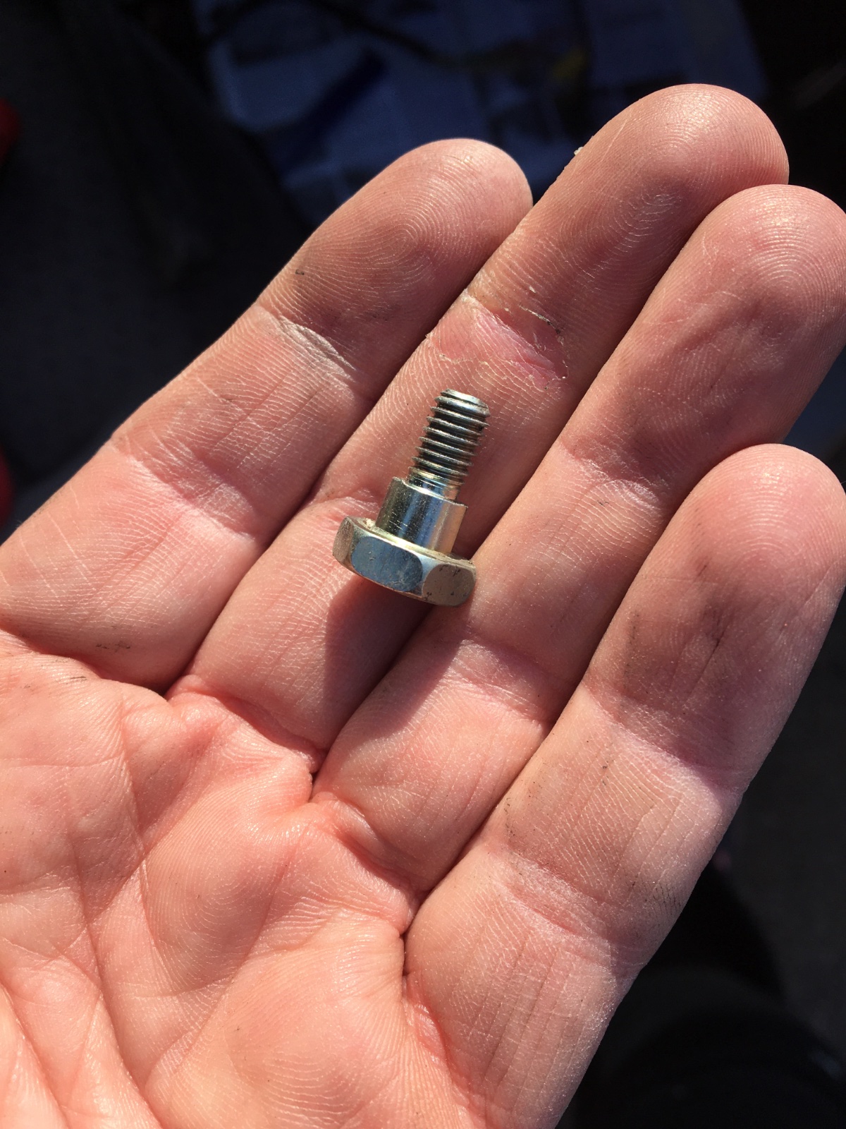

Well. I’ve managed to get it out. Just not sure how it’s going back in.
This dropped out from somewhere!
