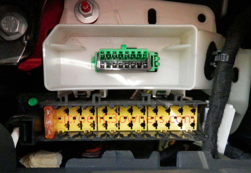

Tried to put OBC11 reader in and noticed one of the pins missing from the diagnostic 'socket' under the glove box. The central locking works from the button on the dash but nothing happens when I try the key fobs - I replaced both key's batteries and have tried resetting the keys doing the 'turn on ignition and press the lock for 10 seconds' and all variations of this trick but still nothing. I also noticed the locking wheel nut adapter is missing a few teeth and the front wheel locking nuts have been butchered (nothing to do with the mobile mechanic).
So to reiterate; CENTRAL LOCKING NOT ACTIVATED BY KEYS, PIN MISSING FROM DIAGNOSTIC (so reader says 'LINK ERROR', and HOW DO I GET THE WHEEL NUTS OFF (to replace with normal bolts that I got from Ebay). PLEASE HELP! (Main problem is central locking).

It’s normal for an OBD socket not to be fully populated, im looking at a C4 one just now & there are only 10 pins in it. Is this what you mean?

Funnily enough I just found a photo of the OBD socket online, which is a relief. I'll get the keys checked as I have been having nightmares about replacing the BSI, ECU, Keys etc...wheeler wrote: 25 Feb 2021, 07:56 It’s normal for an OBD socket not to be fully populated, im looking at a C4 one just now & there are only 10 pins in it. Is this what you mean?
