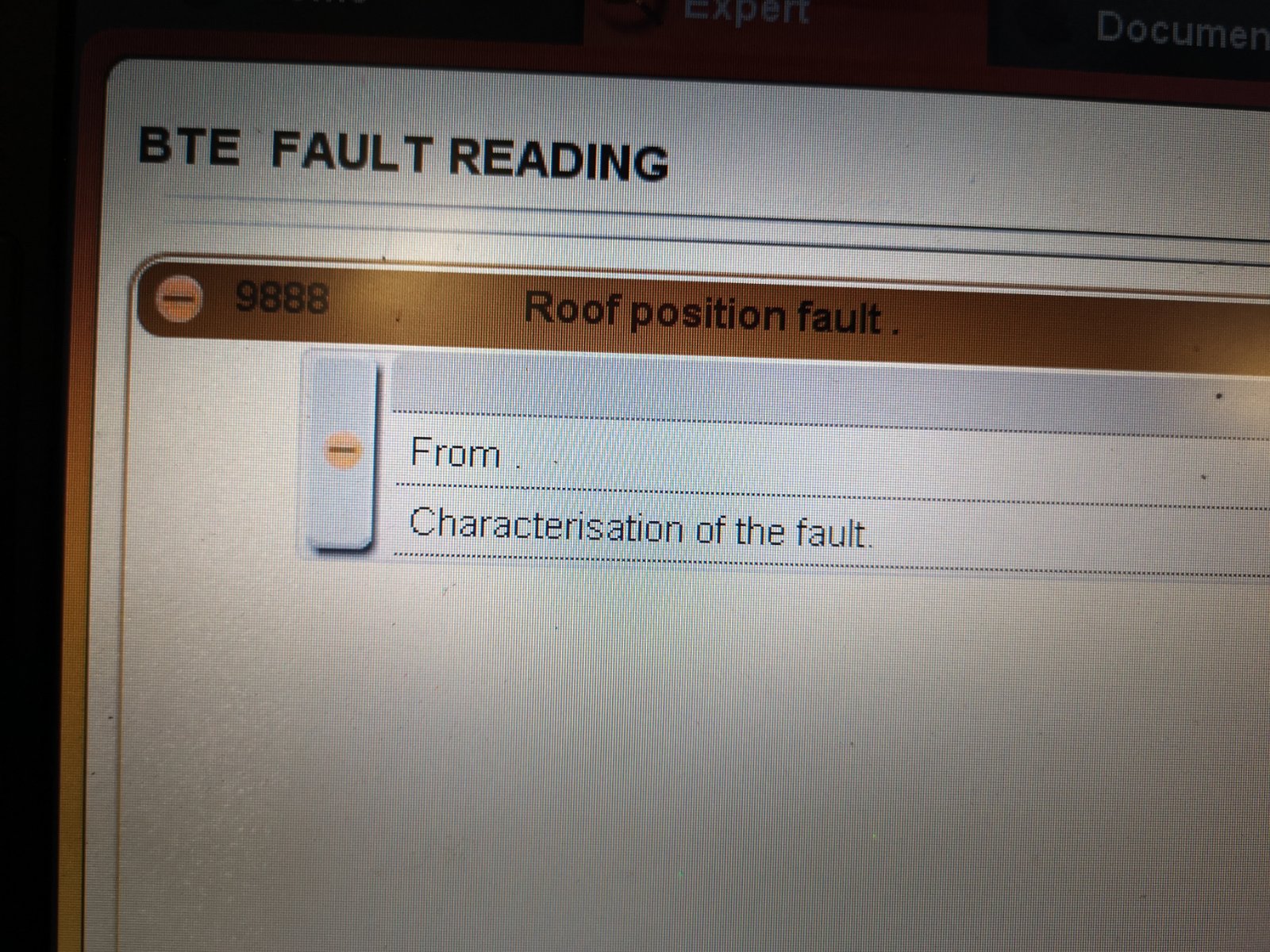

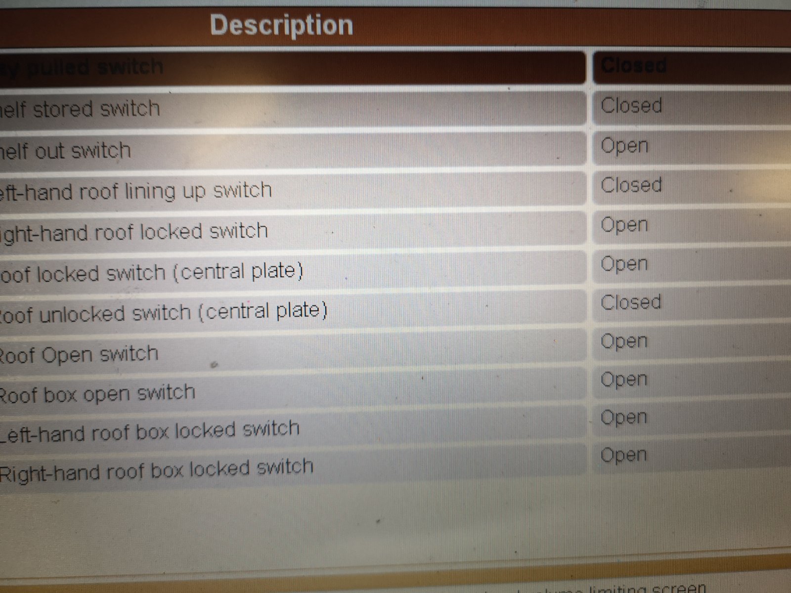

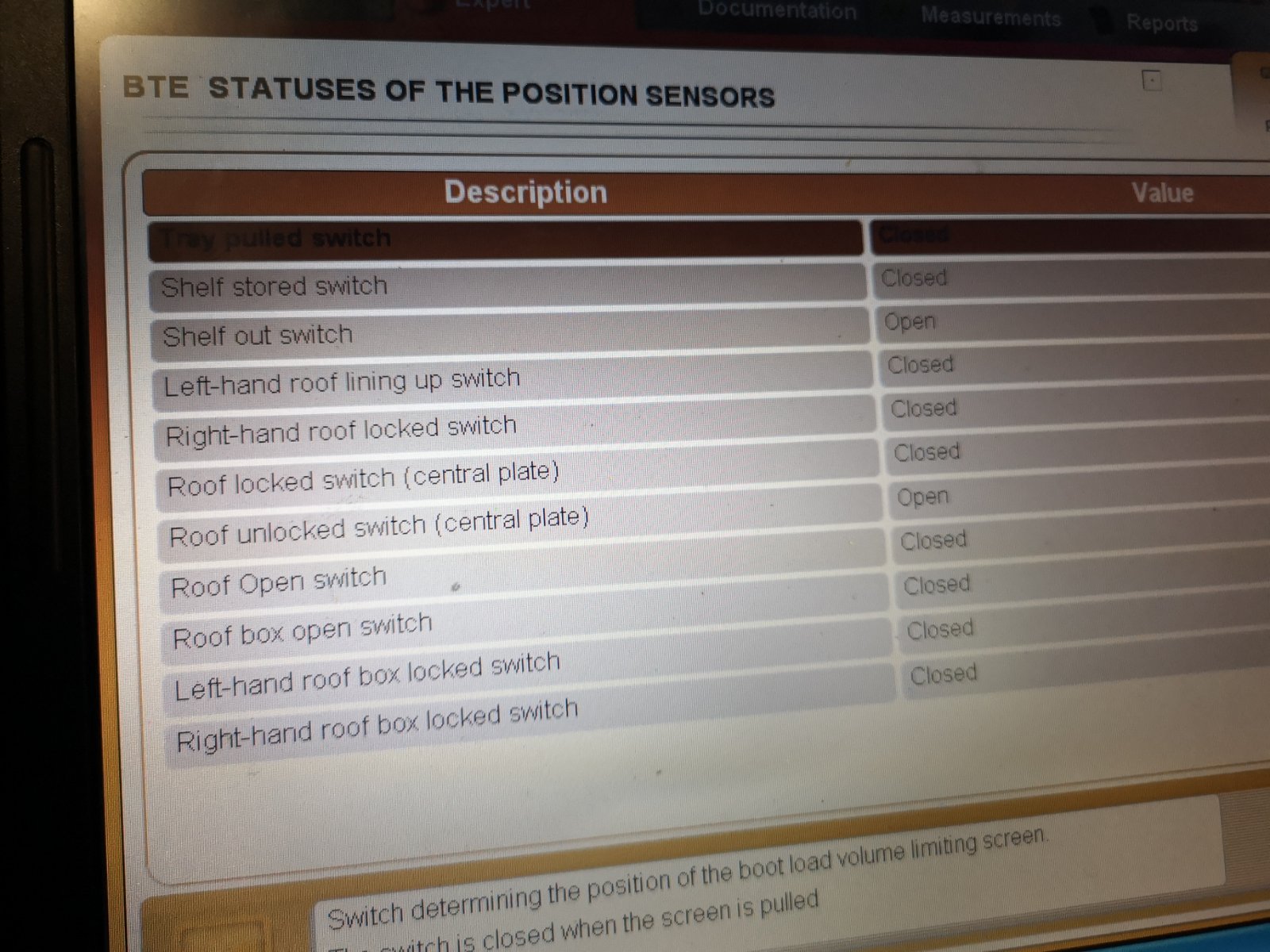

Unread post by bill field »
Hi all I have a 207cc and when the roof is operated it folds into the boot and then stops and then says roof fault and unable to move it in any direction unless i shut it manually .The boot lid stays up and does not close ontop of the roof nor does the parcel tray cover come out .I have attatched some pics of data reading from p planet third pic is the readings when roof is closed and second is roof readings when it sticks open with the boot up and fault code is 1st pic which is 9888 roof position fault ..I have checked wiring and micro switches and they all seem to be ok . Any ideas please? Many thanks
