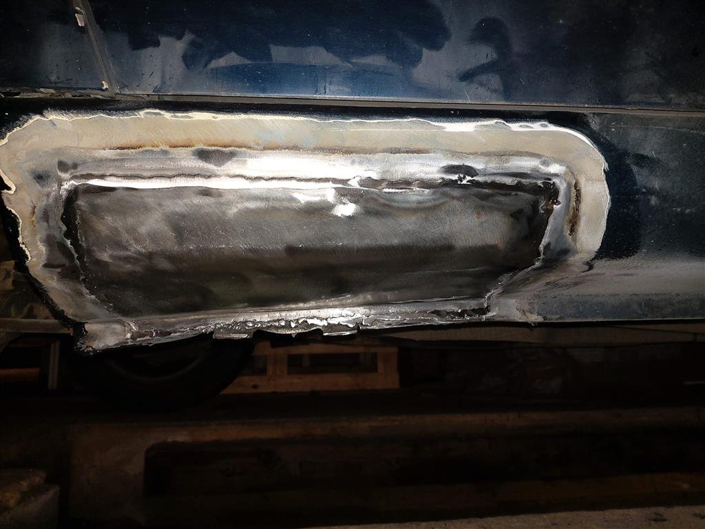

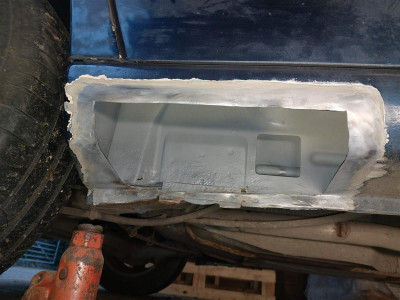

Rust cut out of sill, zinc rich primer applied inside section

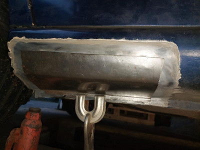

New steel crudely shaped to match the hole and clamped in place
Mig welded (with CO2) in place and ground back

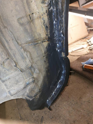

Inside wheelarch, looking forwards. New flexible body mastic to seal panels - should have been done correctly at the factory

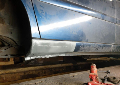

Repair completed and primed, ready for paint in the summer
Hopefully this will keep the old girl rolling for a while yet!
