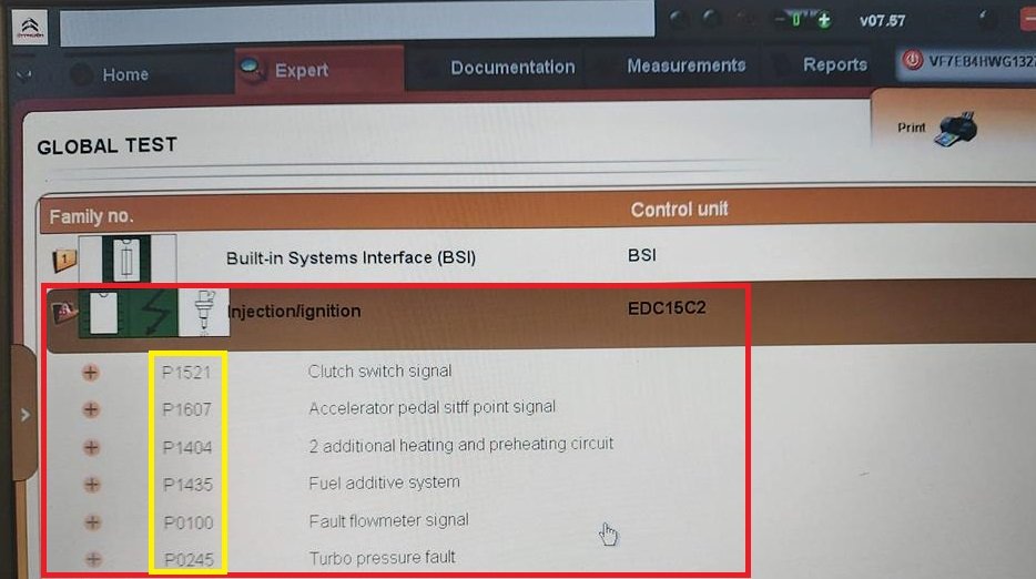

aea_s wrote: ↑04 Feb 2021, 10:55 Hi All,
I appreciate my first message was rather long and didn't work quite right to start with! Thanks to Marc and James for the pointers
The issues I'd like to understand to start with are the fault codes for the injection section of the BSI report in Lexia - this section;
These codes - bold items of particular interest;
P1521 - Clutch switch signal
P1607 - Accelerator pedal stiff point signal
P1404 - 2 additional heating and preheating circuit
P1435 - Fuel additive system
P0100 - Fault flowmeter signal - think I may have cured this one by cleaning the MAF on the intake, it was lightly contaminated with engine oil residue
P0245 - Turbo pressure fault
Is there a manual for these codes that can be referenced somewhere? I've had a bit of a look but can't find anything specific to Citroen.
Thanks in advance,
Andrew
