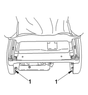

Lower the head restraint.
Push the locks ( 1).
Tilt the seat forwards.

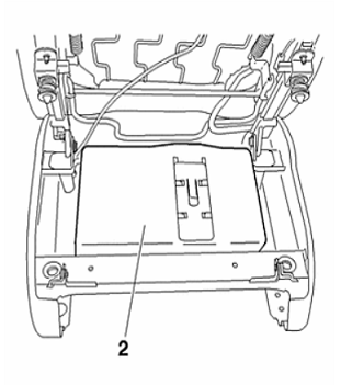

Remove the cover (2).

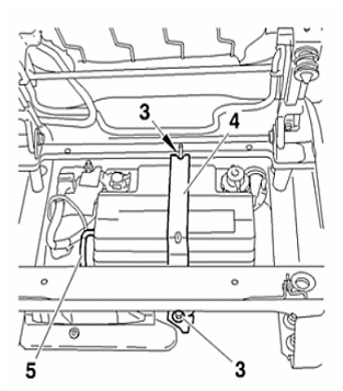

Disconnect the battery.
Note: Mark the position of the battery.
Remove:
  • The bolts (3)
  • The bracket (4)
  • The battery
Refitting
CAUTION: When refitting the battery, it is important to position the venting tube ( 5)correctly, and to ensure that it is not blocked.
Proceed in the reverse order to removal.
