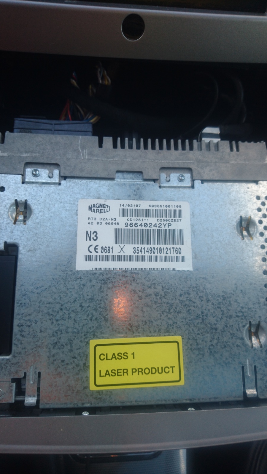

Hi,
I saw there was a similar post here, but as my unit is a different model I ask the same question in hope of a different answer.
I have a broken head unit that needs replacement. Do I need to get the exact same model (96640242YP), or are there other alternatives that will do the job? Please see the attached picture.
Thanks in advance!
x 6957
Re: RT3 replacement
You need the same unit reference as there are different variations for the different electrical architectures used on different vehicles / years.
Some units are VAN based and some are CAN based. You must have the correct version for the car.

I was afraid that might be the case. Thanks anyway for the quick reply, much appreciated!
