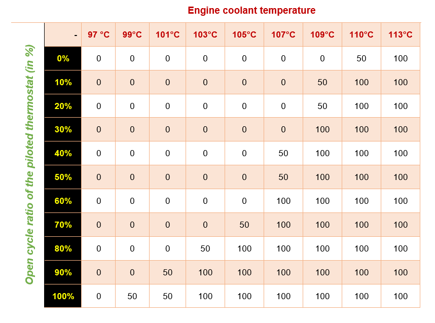

Some of the literature on the control of the water pump on these engines is obviously wrong- I think that it is only the turbo versions of the Prince engine that have electrical control of the friction wheel drive unit. It's pretty obvious given that the VTi units don't have any electrical leads going into them. On my 2007 1.6 VTi I too can turn the friction drive wheel while it is contact with the water pump pulley. The water pump still seems to work ok. I had put a new thermostat in (even though it was the one meant for a Mini Cooper).
I idled my motor until my code reader indicated a temperature of 104C and the radiator fan had still not come on. The car's temperature gauge was showing ~90C- that is pretty standard practice for car manufacturers so us users don't fret about minor changes. I then got into the vehicle and revved the engine and a few minutes later got out and observed the fan slowing down to a stop. There was hot water in the top hose well before this. When the code reader was indicating 99C, the top hose was already 88C. My Peugeot 207 Haynes manual has the thermostat opening at 82C, so I'm wondering if it is the fan that comes on at 105C? It comes on if I use the A/C.
After about 4 or 5 engine starts since my engine rebuild many of the initial faults (many light bulbs and engine) have disappeared, except for my ABS which remains. The car is not registered so I cannot really drive it. I have not tried to do a BSI reset, am just hoping that it might sort itself out like it did for the variable valve lift setup, where I didn't have to worry about setting end stops (and wouldn't know how to) - it just idled badly for the first couple of runs.

Dannyboy, the thermostat will open regardless of any electrical problems with the heater at 82C as it is basically a normal wax pellet, augmented by a heater for unusual situations when it is driven hard when cold. The symptoms sound like the problems Citroen had from 2013-15 when they loaded the wrong cooling software at the factory- overheating and coolant loss. They were very coy about the details of this recall but I am presuming it only affected turbo vehicles with electrically controlled friction drives? I will have to think about this.

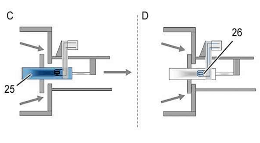

Dannyboy, I was wrong about my thermostat test in boiling water- I repeated it and it didn't open. On this forum if you search for electronic or piloted thermostat you will see detailed information from GiveMeABreak about the operation of these thermostats. This confirms that the normal operating temperature of these engines is 105C. And that the wax starts to melt at 105C. The engines can run at lower temperatures under certain conditions such as heavy load, but as Marc explains there are many variables involved.
On another forum: https://bobistheoilguy.com/forums/threa ... at.225373/
" My Peugeot 207 1.6 is acting up as I get an overheating alarm but the car is totally cold, checking in other forums it seems that is a common fault of the temperature sensor or of the thermostat, ... This was cured by replacing the thermostat.
And: My Mercedes has something similar to this (not sure if it's exactly the same), but I know how it works. It has a normal wax pellet type thermostat, but it is set to open at a very high temperature of 110 C by itself. It also has a "heater" built into the thermostat so that the car can "fool" the thermostat into opening a lot earlier. According to the service manual, the car can decide to open the thermostat anywhere from 80 C to 110 C, although I personally have only ever seen a variation from 85-95 C in the driving that I do. So, if I were to put my thermostat in boiling water, it wouldn't open. But in the car, with the electric heating element working, it can open as early as 80C.
The fact that the temperature gauge only ever reads about 90C during normal driving is just a cunning ploy by the manufacturer to keep us happy. And PSA are not the only ones who do this.
I am guessing that at the moment you are running just water as coolant? My engine reconditioner would have me run plain water for 600km after a head gasket replacement, but I am now wondering if this could cause localised boiling without the raised boiling point provided by the glycol?

Not sure if this will help but was posted in relation to my lads 2009 207 1.4
ColinGiveMeABreak wrote: 11 Feb 2020, 15:29 Here's some info on the system incorporated into the TU3AE5 engine, which uses a piloted thermostat Colin.
Its role is to accelerate the engine temperature increase in order to improve the exhaust gas emission control and to obtain a higher engine operating temperature to reduce friction and fuel consumption.
The thermostat is open (whether in piloted or non-piloted mode if the temperature is above 105°C).
During normal operation, the thermostat is not piloted, it regulates the coolant temperature at 105°C.
For full engine loads:
- The injection ECU controls the regulation of the thermostat at 89°C
- The injection ECU controls the piloted thermostat heated resistor (26) in order to add the 16°C which the coolant lacks in order to melt the wax (25)
The piloted thermostat opening control is determined in relation to the following parameters:
Time Operating Phase Description of the Operating Phase t0 and t1 Partial load The engine management ECU does not activate the piloted thermostat regulation control.
The engine coolant temperature is regulated at 105°C guaranteeing a reduction in consumptiont1 and t2 Full load The engine management ECU detects a full engine load and controls the opening of the piloted thermostat by means of the internal resistor which melts the wax, simulating a temperature of 105°C.
The engine coolant temperature decreases and stabilises at a temperature of 89°Ct2 and t3 Full load The engine cooling is regulated at an engine coolant temperature of 89°C in order to avoid an excessively high engine operating temperature t3 Partial load The engine management ECU detects a partial load and no longer controls the activation of the piloted thermostat internal resistor.
The piloted thermostat again regulates the engine coolant temperature of 105°CNote: Bleeding of the cooling system uses a special injection ECU strategy.

Key:The piloted thermostat opening control is determined in relation to the following parameters:
- 50% = Slow speed
- 100% = High speed
The parameters of the cooling fan post-cooling triggering and duration map are set by the coolant temperature and the exhaust line temperature sensor.
