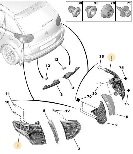

Sorry I should have been more clear. I's for the NSR cluster on the quarter panel with the tail lamp, brake lamp and indicator bulb. The pins where the harness plugs into have corroded and causing issues with the indicator.GiveMeABreak wrote: 23 Jan 2021, 15:34 What exact bulb holder are you referring to? Rear Tailgate, rear body lamp holder, rear courtesy light???

Ok, so have a squiz at the diagram. The rear cluster comes as a complete unit apart from item (5) which is the 'Light Skirt'.
So item (1) is the rear cluster on the wing.
There are 2 possibilities for the vehicle (probably as a result of range changes midway through production), As your front headlamp is classified as "Except Range Activity", I would suggest you need 6350CA from the choices below:
6350CA is the one ("Except Range Activity") £107.78
6350LQ ("Range Activity") £167.94
Prices as of today all inc. of VAT from Citroen.

Thanks for that Marc. I was hoping the bulb holder would come as a separate part and preferably aftermarket. For that kind of cost I think the soldering iron will be coming out
