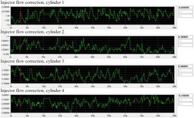

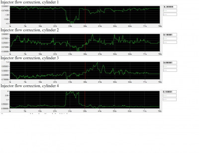

Running a bit rough, sometimes bit jerky then it seems to clear and run ok.
Used diagbox and captured a couple of runs - the pic from 18th shows the Jerking part half way through.

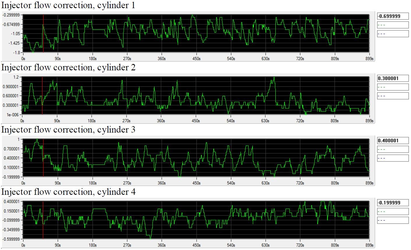

The pic on 19th is a normal run.

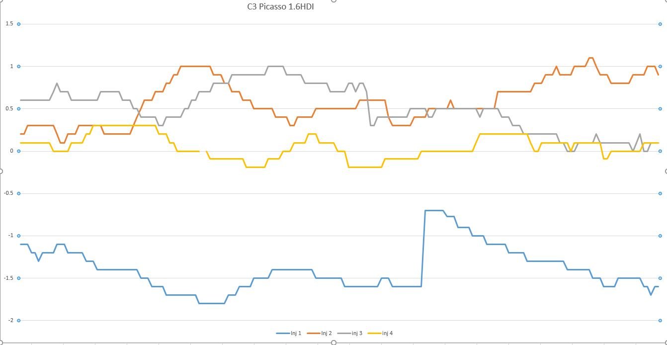

Have taken first 90 secs of the run on 19th and plotted in graph to show all 4 - do you think #1 need to be replaced ?
