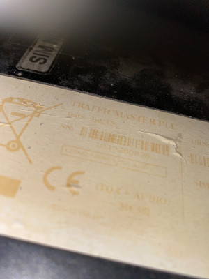

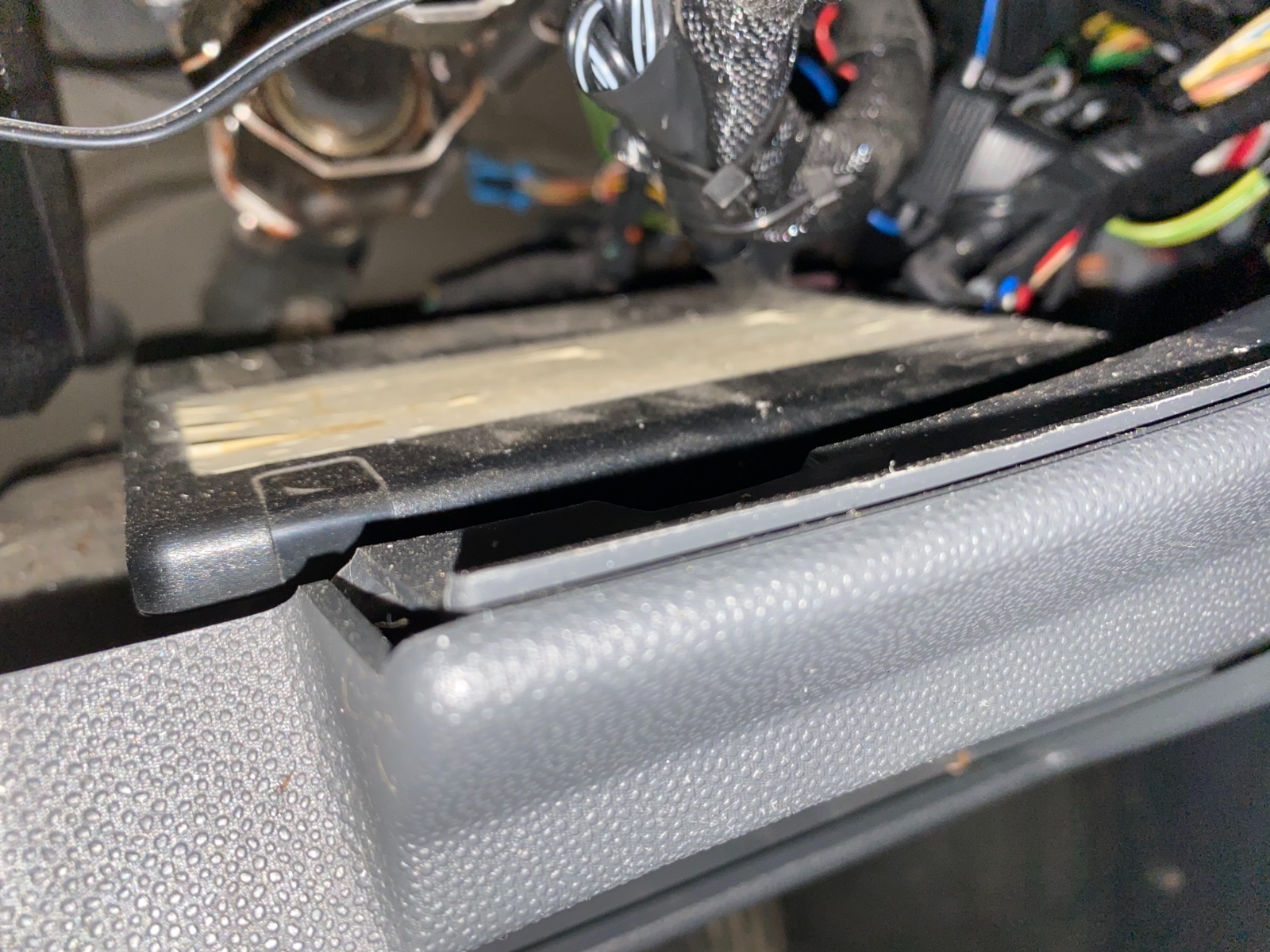

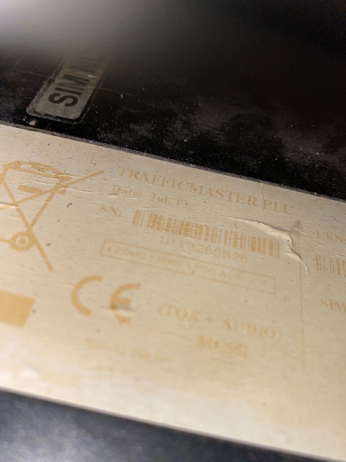

I’m looking to fit an alarm to my dispatch, whilst taking things apart I noticed a box under the steering wheel with a load of cables going into it. It says traffic master plc on top. Does anyone know what this is?

Obsolete now and was pretty much rubbish when it worked.
I think that there are traps when removing it as in at least some Citroens the audio is piped through it, so it can interrupt any programme playing with it's inane announcements.
I think that Paul (CitroenXM) had a method of removal that fixed this but more I can't remember.

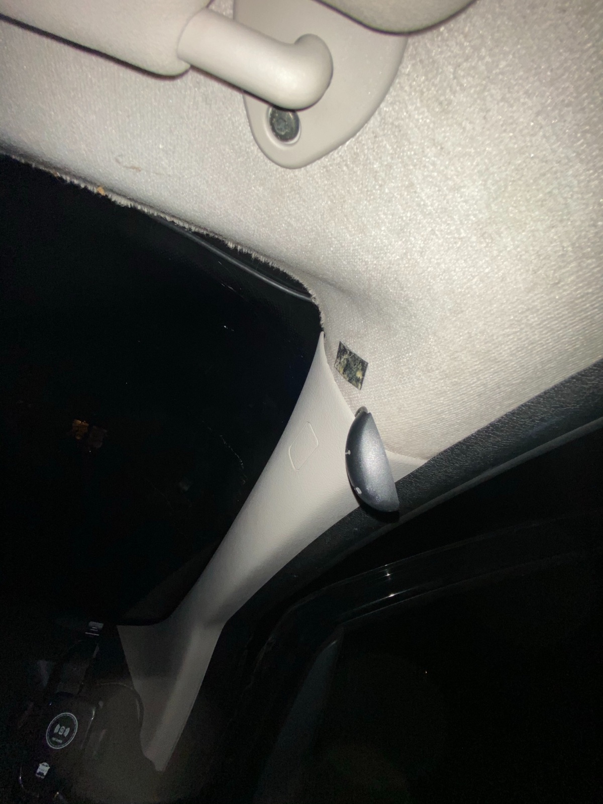

Also from what I can tell from tracing the cable this sensor/ mic goes into the box, what could it be? As it’s not the mic for the hands free?

Its a system called smart nav (made by trafficmaster) it was a dealer fitted add on to many of the commercial range, there should ld have been a detachable basic navigation screen mounted at the base of the A pillar. The mic is part of it as you could call trafficmaster & ask them to look places up for you & plot in the directions. The system is from around 2005 so before google maps & smart phones. There would also have been a hockey puck GPS aerial on the windscreen. Even if it is still operational i can imagine anyone would keep the subscription up nowadays.
As it was an add on if I remember right it had its own external speaker so it should be removable without any issues to the original audio unlike the factory fitted trafficmaster systems.
