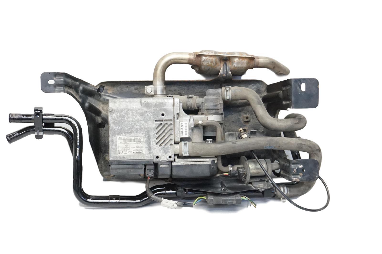

Here’s the unit removed from the car :

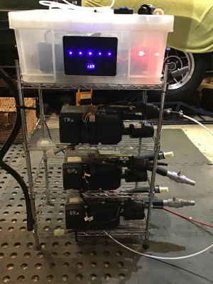

How come I know a bit about the Webasto ? Well I built a unit comprising 3 units (putting out a total of 15kw) to heat my swimming pool !
