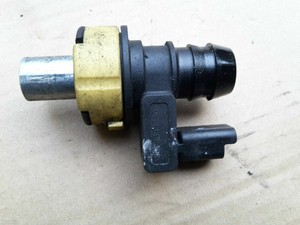

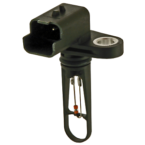

So i thought it might be the air intake temp sensor, since theres no chance for me to preheat that sensor, but searching the net it shows two different kind of sensors.
Either this:
Or this:
Anybody knows the difference and which one is the right one?
Still a bit confused as to why air intake temp makes a problem that the ECU thinks its the throttle body.
